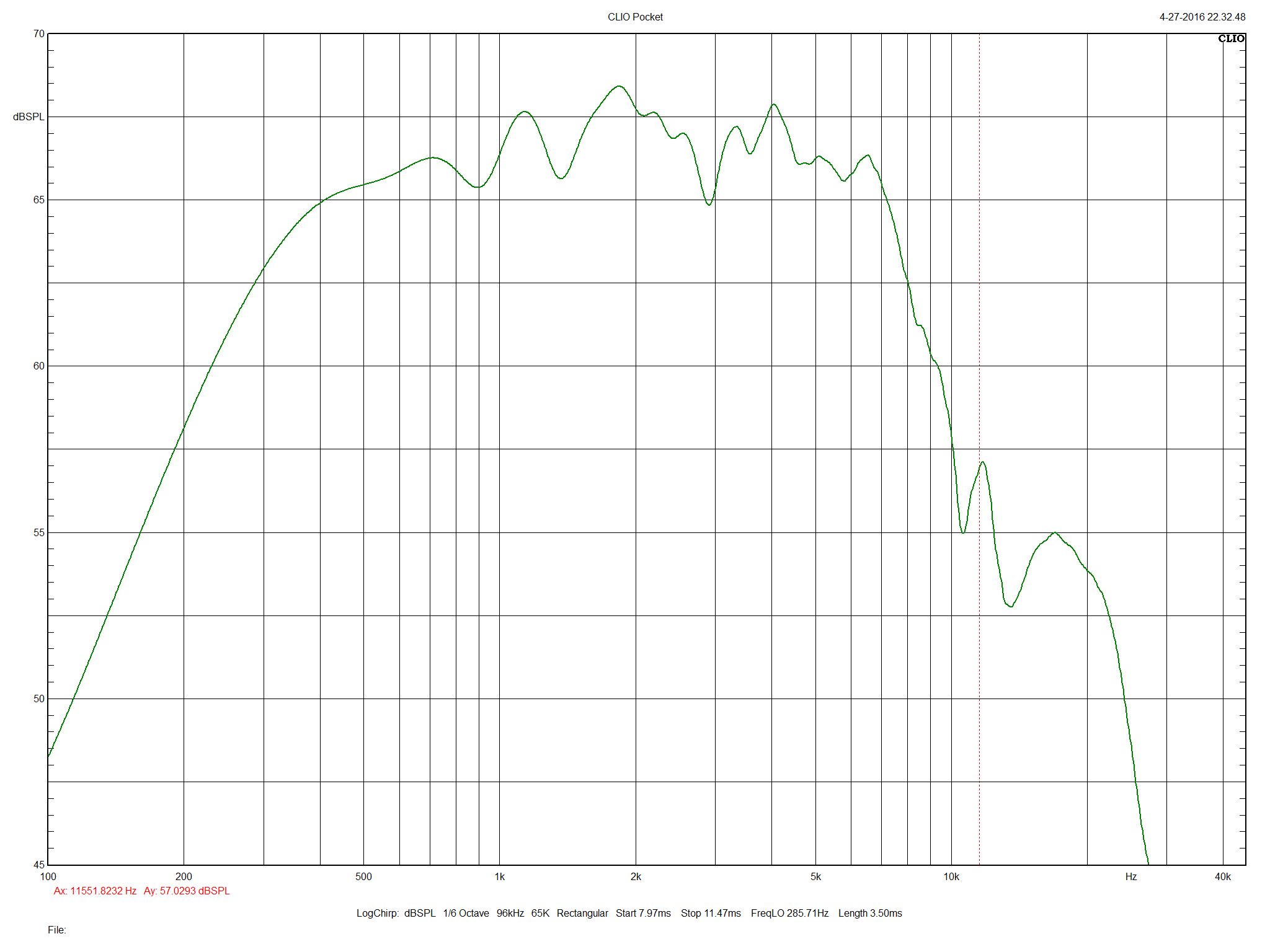

PostPosted: April 27th, 2016, 11:11 pm
Posts: 928
Now this looks more like a speaker response plot! Finally got the time gate working on Pocket CLIO.
Looks like a decent midrange. Did not try to run it with a 2.83VAC log sweep for a standard sensitivity run at this point.
