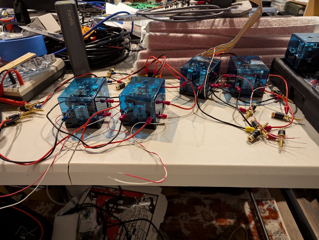

Building the ABC Switch relay wiring and testing the drive circuit. Using 8-DPDT replays with silver contacts for the speaker level switching between the crossovers.
Decided on a RPi5 using Thonny for Python 3 coding for the logic drive to the GPIO ports. A ribbon cable to the driver board.
Simple relay switching with power MOSFET VN10KM drivers. Each relay coil is 12VDC@0.203A, so the small VN10KM devices will work without a heatsink.
The SMPS is working and will power the RPi5 and all the relay coils.
