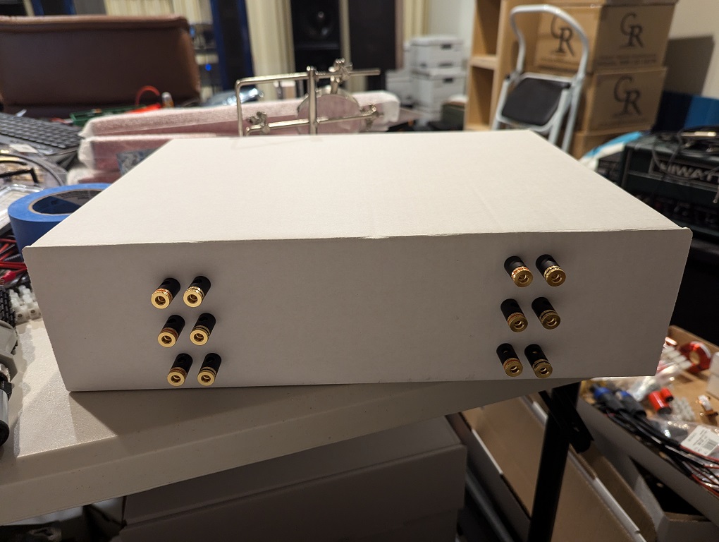

The first ABC Switch relay box #1 prototype is done. The Neutrik connectors are relay switching signals on the front with the outputs to the speaker drivers.
Rear connectors are the ABC inputs from the different crossovers.
Now to build relay box #2.

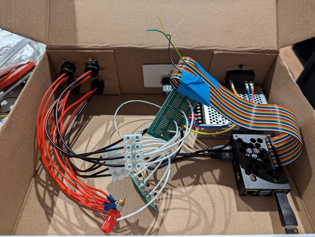

Built the relay controller boards and wired them to the relay connectors and SMPS.
Next is wiring the RPi5 ribbon cable to the controller boards and start testing the ABC Switch.

The ABC Switch RPi5 and Relay control boards are now connected.
Time for some relay testing for channel #1 then swap to channel #2. Then onto both.

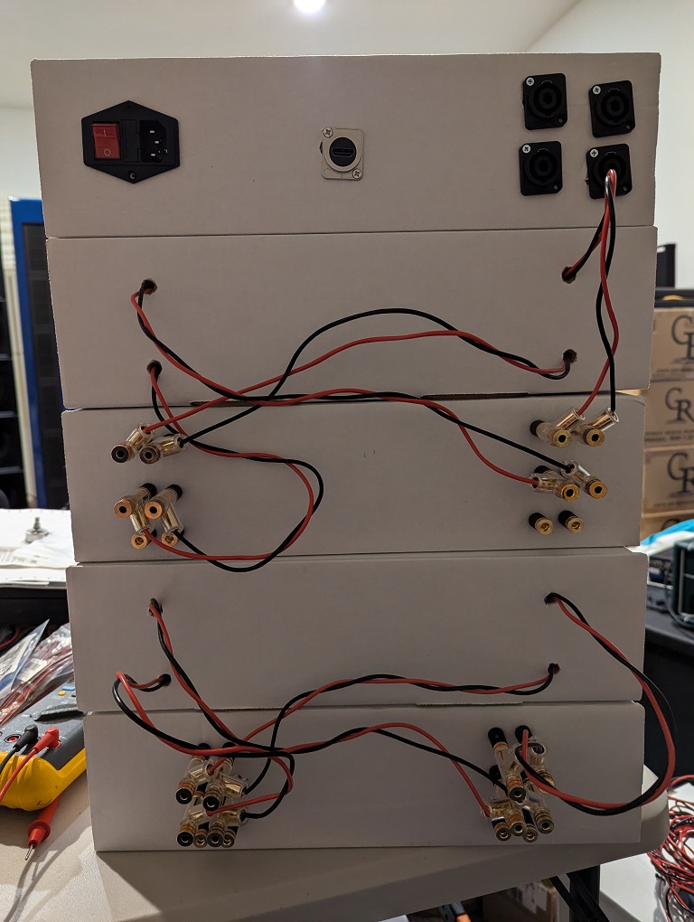

The M1 speakers ABC Switch System is ready for testing.
This is the original passive crossover, upgraded component passive crossover and inputs for the dspNexus 2/8 DSP crossover system.
Now for system connection and listening trials. Need to level match the 3 crossovers. Cable lengths for each channel are 8ft of Belden 1309A 14awg speaker cable without the PVC jacket.

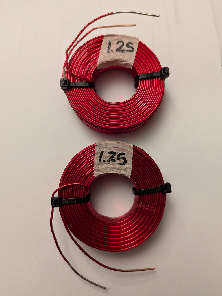

For the upgraded M1 speaker crossover, the original value of two inductors used is not a stock value. Had a matched pair of aircore inductors made for the new passive crossover for the ABC Switch box system.
I will install these and ready for system installation and ABC crossover trials.
