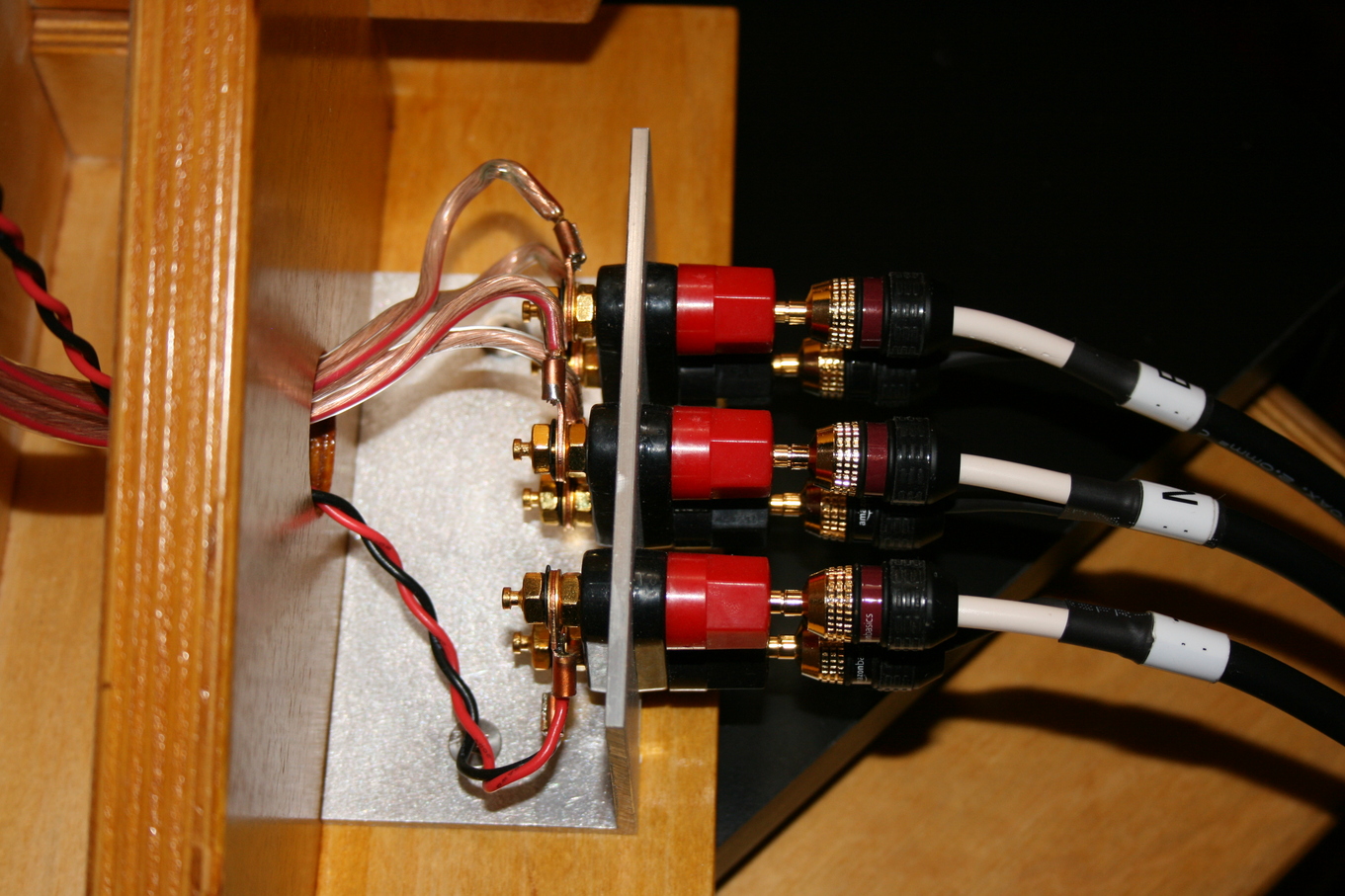

I have a Fostner bit to drill the holes for the second type of binding posts if you want to borrow it (requires a drill press) or drill the holes in my shop. Here is the connector panel for my LX521.4 -
