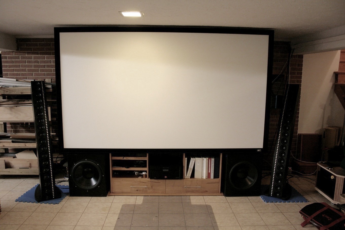

If we are talking about finishing mdf I like two methods. For the bezels (speaker mounting surfaces) I like shellac with dye. If you want black after sanding apply black from large indelible magic marker then use dyed shellac (you can just rub it on with a cloth). Also use Formica with contact cement. Then you need a trim router with a ball bearing bit to cut it to exact size after gluing it on the mdf.
All the speakers in the photo were finished with of combination of the two methods.
