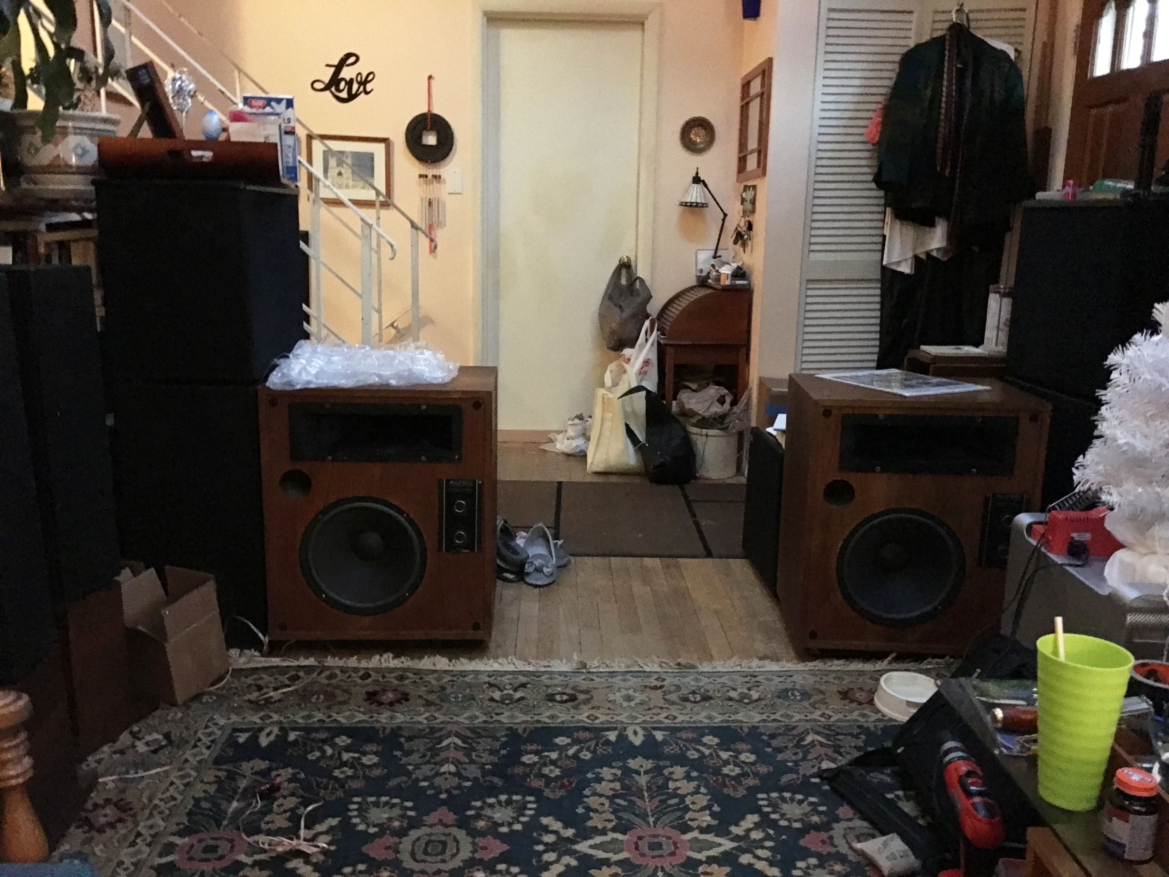

And while I wait to assemble drivers and such, I'm listening to the rare old JBL L212s I fixed up last year at this time,
with a volkswoofer around the corner picking up the bottom

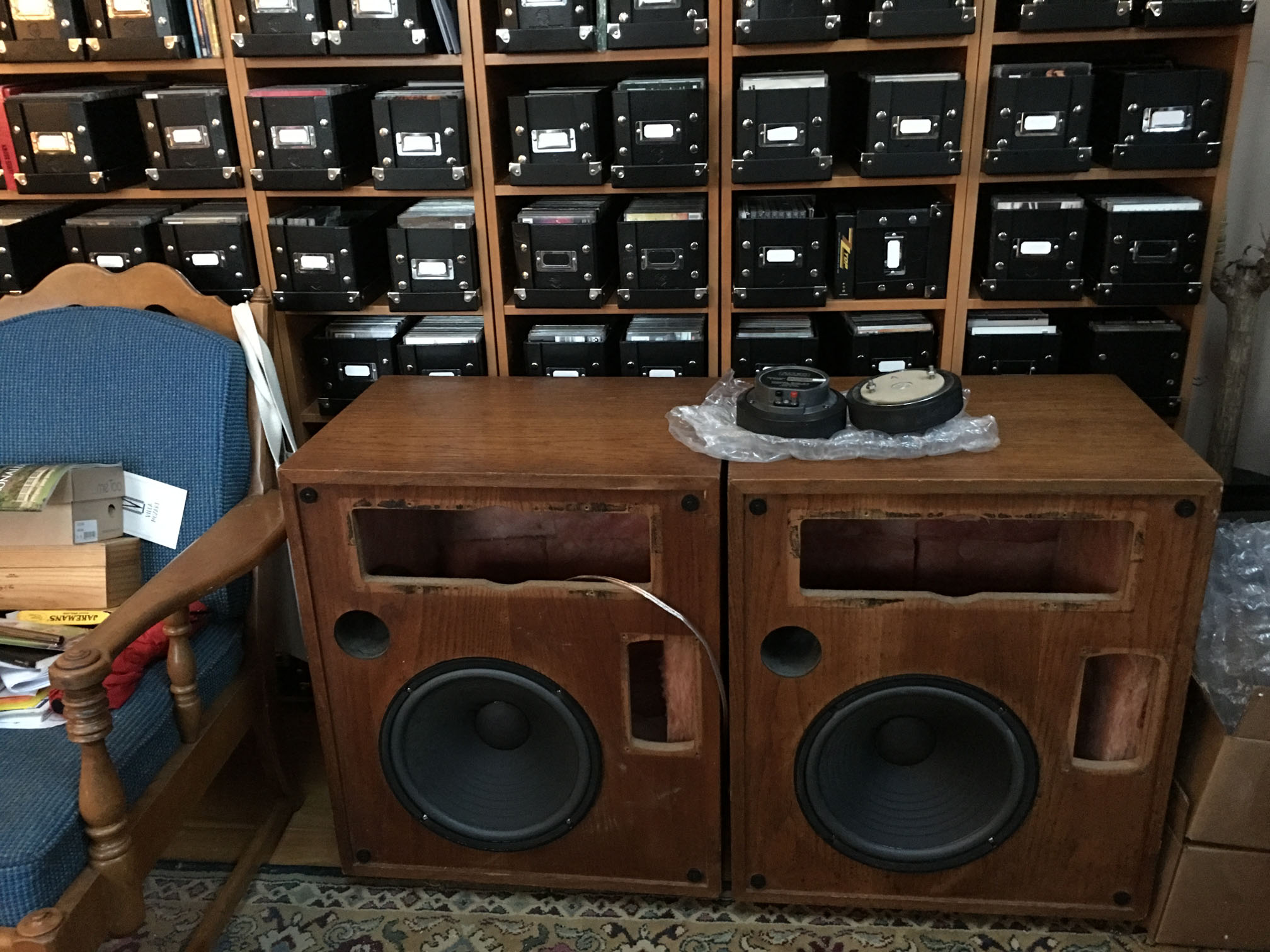

Was chasing old links I had last night and ran across someone with a parts pile from a pair of Model 15 series II speakers - so, I'm buying their rebuilt crossovers and the (plastic) 32 horns. So between them, the 902/908 drivers and the JBL 2214 woofers, that should be enough parts that I can get some sounds out of the cabinets and see what's up.
Of course, with all this east coast snow, it'll probably be a week or two for shipping and assembly at my end ...
More info and pix when available ...
