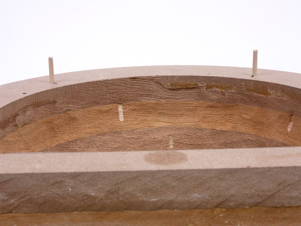

It's a tough call whether to do it with a CNC router or using templates for each layer and cutting out with a jig saw or router. Shashi is correct that the shape will change in both directions. You will also have the problem with registration of the individual layers. For my eggs I cut 18 sections with a router and used 4 1/8" holes in each piece that held sections of 1/8" dowel as registration pins when I glued the pieces together. That was a total pain and you still have to shape the rough edges by hand. I'll never do that again. If you could afford it I would go with the router. In either case you may wind up with a shape that does not give you the results you expect.

If that is the case then I would prototype out of ridged foam. Very cheap stuff, can cut with knife or even drywall saw.
For the most part the horn will not be expanding in any other directions than you see in the drawing, so all the layers should stack up perfectly flush.
I'm going to run threaded rods all the way through the fourteen holes, and I think I'm going to try to not glue the layers together. Nut's on the outside will hold everything together.
