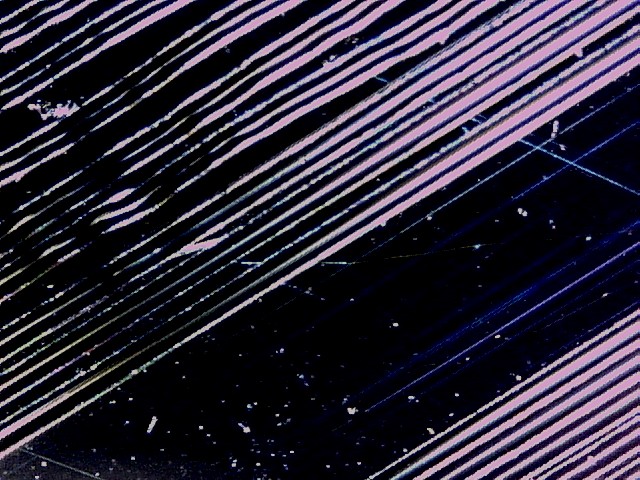

Funny thing you would mentioned record cleaning. A year ago I built an Ultrasonic cleaner and was sold on the idea that I could clean 9 lp's at a time.
Well I have since gone back to the SpinCleaner. This is an $70 product that bested my Nitty Gritty and Ultrasonic cleaners easily
I use my own mix which is the standard 3 parts distilled, 1 part 90% isopropyl and a few drops of Kodak Photoflo
I have tried many commercial products and saw/heard any differences. What matters is if the record is very dirty do multiple cleanings.
I clean new records at least twice and used records a few to many times.

Neat. What are these photos, exactly? Presuming some sort of photo of a record?

The pics a 200 magnification of an dollar yard sale LP. Starting from the bottom each pic is an additional cleaning and you can see they are getting cleaner as you go up
