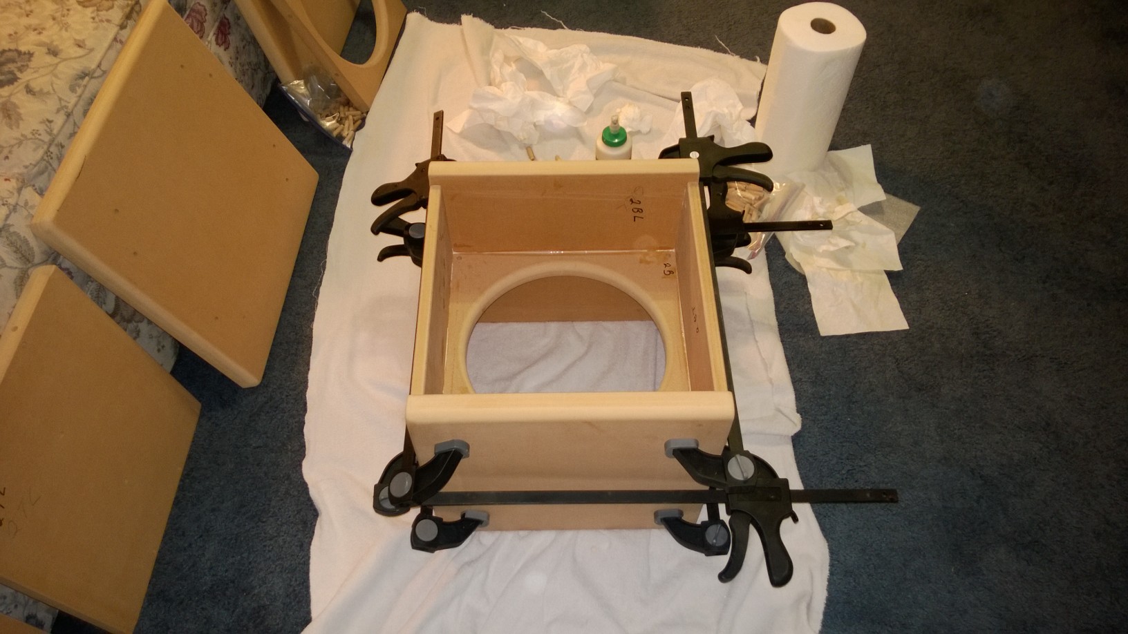

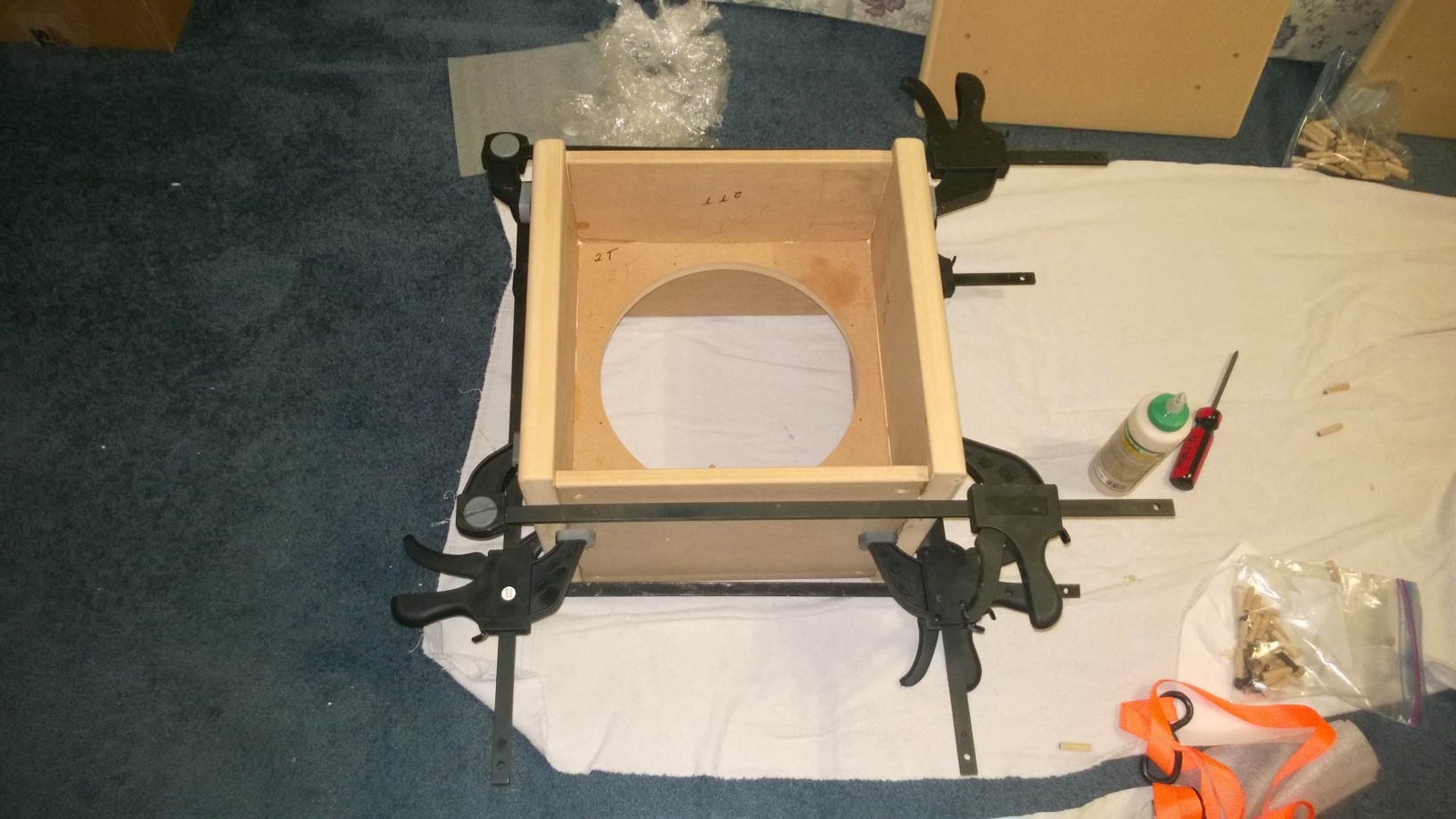

PostPosted: January 3rd, 2018, 11:40 pm
Posts: 908
Servo sub modules #1 and #2 glued today and drying overnight. Working on #3 and #4 tomorrow.

PostPosted: January 4th, 2018, 9:38 am
Posts: 908
Test fit the first cabinet together and looks good. Time to build the second one. Now that Snowmageddon is here probably not going anywhere soon.
