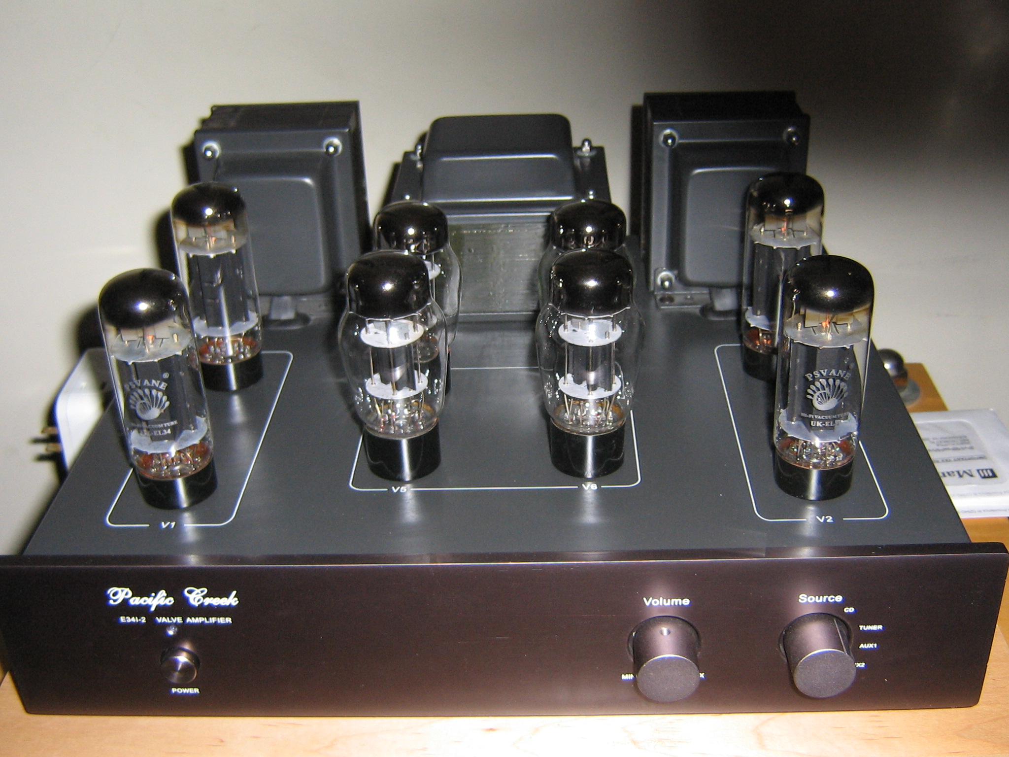

Hi all,
I have a great Pacific Creek E34I MK2. ( Retail about $950 for the standard version, MK2 was a limited edition intended as sort of an executive product) It's a little bit nicer!
It's in perfect working condition. I recently have spent a lot of money on defective tubes, and I'm just a little fed up that the tube I like the sound of best comes from China, and I'm having a hard time getting a reliable set.
I want to go back to Solid State, but I'm a little bit spoiled now with the musicality of tubes.
I'm looking for low wattage (100W or under) super high quality sound that is "analog like". It has to be Hi Res and brilliant with a lot of subtle details!
MY CD PLAYER HAS A HIGH QUALITY PREAMP, SO I'M LOOKIN SPECIFICALLY FOR A POWER AMP!
It should be relatively new, and I would certainly consider something modest that has been modded by some of you who know what you are doing, or built from scratch altogether (as long as it looks pretty!)
The Pacific Creek like I said, is in stunning condition 9/10, and an all over very high quality piece of equipment. I'm looking for a direct trade. I would require an audition! That would give you a chance to evaluate my claims too.

Your tube complement appears to be EL-34s with 6SN7s -- Yes? No? If your amp. has fixed bias on power tubes you may have it set for a higher bias current than what is needed for good sound and long-term reliability.

Hey, so with the new tubes, the lowest tube was around 435mv, so I tuned the rest to 440. I have had other tubes and I usually tuned to around 350mv or so. The amp sounds beautiful either way. I don't have any sense that the tubes are being over, or under driven in this range in any way based on listening. it's just that the new tubes are not keeping a stable bias current from one day to the next, and I'm getting frustrated with the process. It's really more of a mental problem, than a constructive complaint of what the amp sounds like. The amp sounds great!
