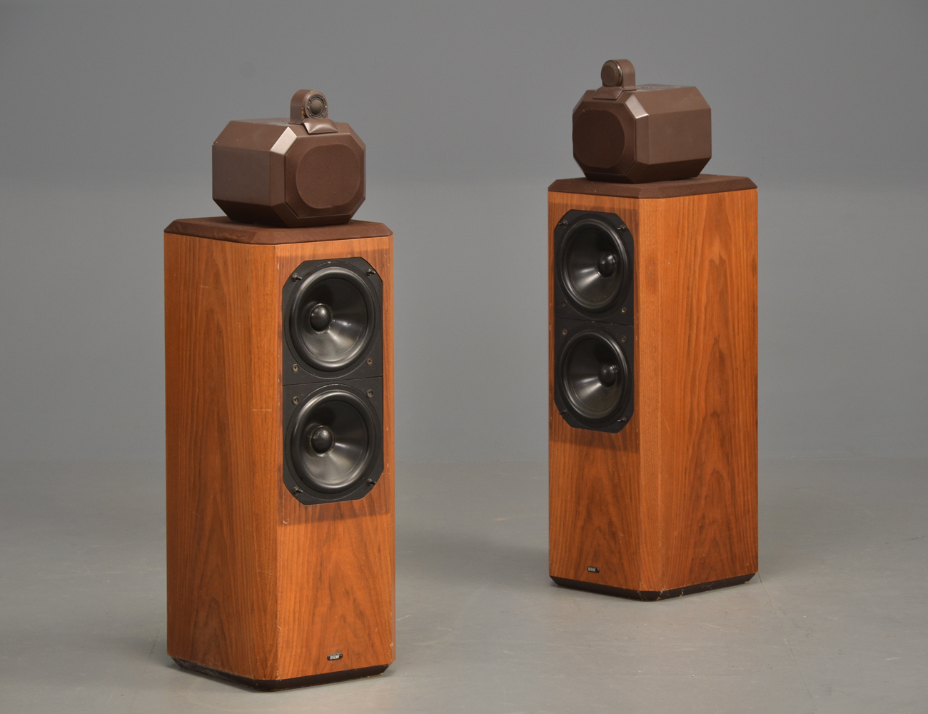

The speakers upgraded were the B&W 802 series 80 F models with a complex fourth-order Butterworth crossover network that B&W bragged about using a computer program to optimize.
WOW! Yet – they used polyester capacitors for the tweeter networks (tizzy and edgy sound), bipolar aluminum electrolytics for the mid-range networks (muffled and indistinct), and aluminum electrolytics for the woofer networks -- and to add insult to injury they capacitively coupled the woofer networks to the drivers through 1,000-ufd electrolytics (grungy and muddy sound).
Additionally, it seems that they were a bit too aggressive with the crossover points because I presume that when you take into account the series and parallel L/C reactance combinations there were numerous resonances that could be mistaken for mechanical issues created by the drivers.
Yet B&W used high-quality inductors , PC boards with nice thick traces, and their drivers are probably the best available even compared to now.
The attached photos are of the speakers and the component and foil sides of a crossover prior to the upgrades.

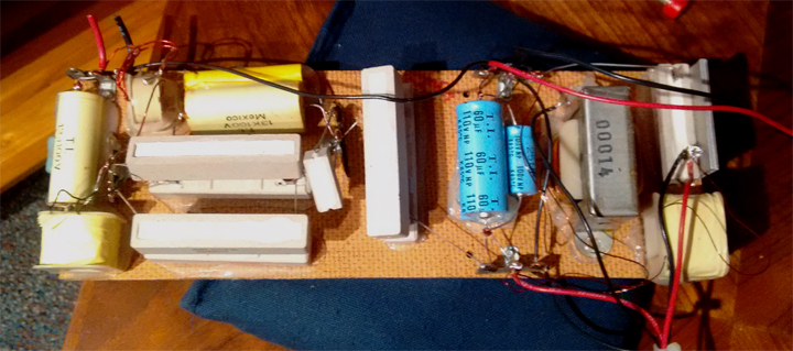

Maggy llla rebuilt xcover. I went for low DCR and I believe I gained a lot of efficiency. Large ga coils, caps in parallel to lower DCR and the Maggys sing with as low as 100 watts.
The second pic is the Carver ALS stock filter, and as you can see tiny ga wire in coils, 10 cent film caps and electrolytic caps.
This is typical of stock xovers. My 200 watt SS amps(400 into 2ohms which is where the Carver are) would not do much.
I replaced th passive xover with Litz-Riley and the Carvers are exciting, not very Amazing but exciting. I do not run out of steam at 110db at 20hz, but my house cannot take much more
