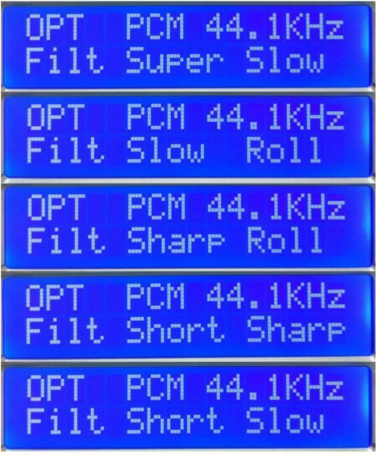

The AK4495SEQ board has filter selections, but no description. Think I figured it out 4, but there is a 5th filter not selectable that is new called the superslow rolloff for the S version chip. Have to figure that one out as well.
Probably get it after RMAF, so will work on it then as well.
All five filter are selectable according to this DAC on Ebay.
http://www.ebay.com/itm/131920789780?_t ... EBIDX%3AIT

The AK4495SEQ has filters that are not linear phase as the reconstruction filter, so wanted to try that for the headphone amp. The AK4490EQ works very well with the slow rolloff filters. Want to try the superslow filters next.
