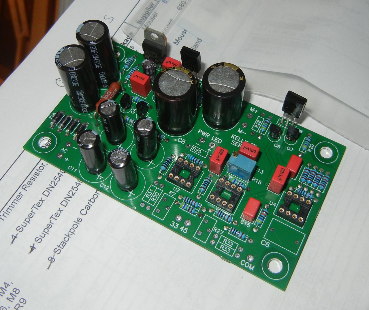

Figure 24 shows the controller board mostly loaded with components. The op amps (U3, U4) and voltage reference (U2) have not been plugged in, and the resistors that set platter speed as also missing. The pots (R7, R27) that adjust platter speed were actually mounted on a piece of perforated board and suspended below the top of the motor enclosure so platter speed could be adjusted while the enclosure was assembled (see Figure 22).

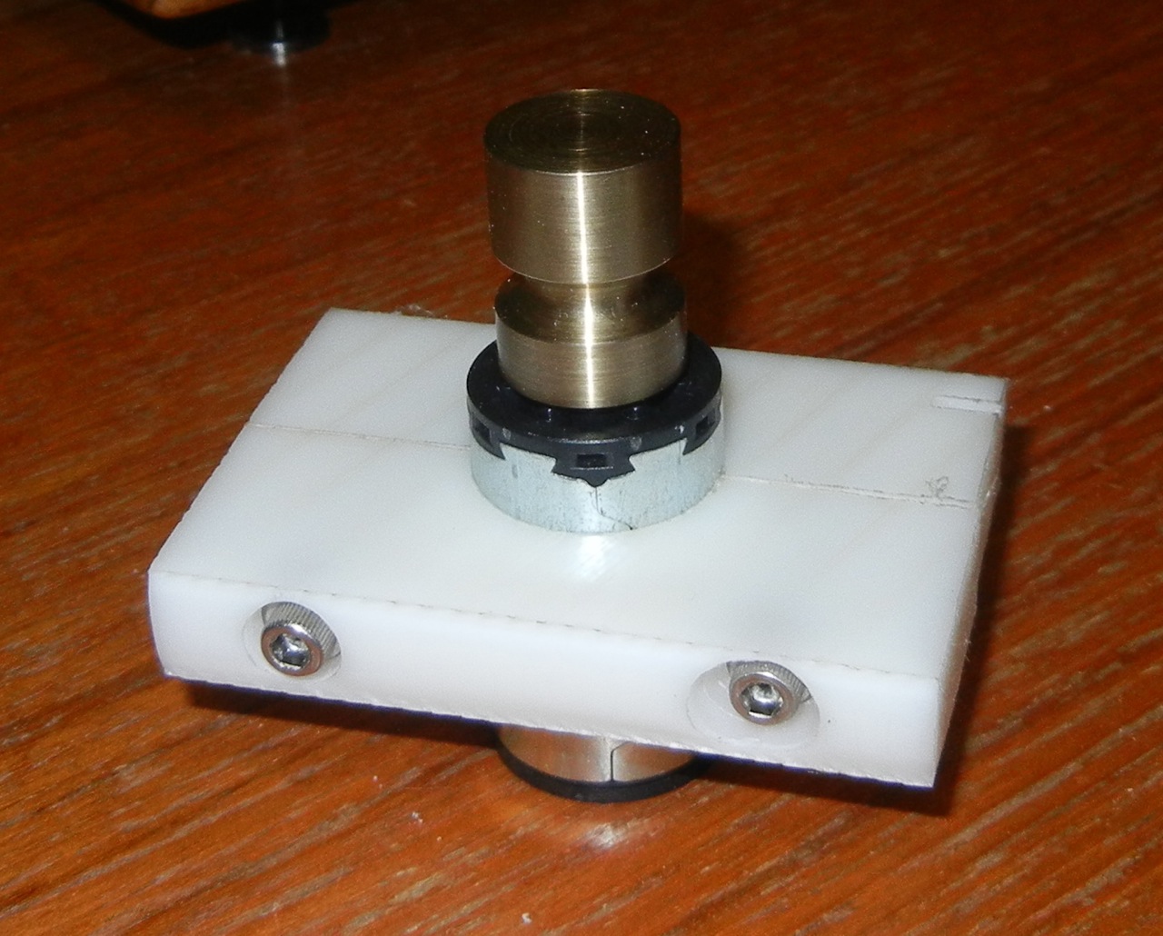

I mounted the motor between two pieces of ½“ Delrin with a 1” hole in the middle that pinched the motor and was held tight by two screws threaded into the Delrin (see Figure 26). This mount is attached parallel to the underside of the motor-enclosure cover with four screws (see Figure 22). Note that the two sides of the motor mount did not touch, and pinch the motor tightly between them.

To make the motor mount, I drilled all holes first, and then cut the piece in half, as described in Figure 27. Because the motor was a little bigger than 1” in diameter (actually is 26 mm), I had to enlarge the 1” hole with file so it would fit the motor. I then tapped the holes in the upper half of the mount (the piece farthest from the screw heads) for 10-32 hardware, and assembled the two halves using socket-head screws. The motor was adjusted up and down until the top of the motor was flush with the top the enclosure cover, and then the two locking nuts were tightened.

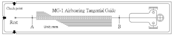

There was an initial setup to align the tonearm to the platter. The cartridge was attached to the head shell of the tonearm wand. The tonearm should not be moved on the air beam without air applied, so the pump was plugged into the wall, and the black tonearm air sleeve was slid onto the silver air beam. A retainer screws onto the end of the air beam to keep the tonearm from sliding off. This feature also allows the user to buy another tonearm and quickly exchange cartridges. A tracking force of 1 – 2 grams was placed on the cartridge, and one of the templates provided with the tonearm was put over the spindle on the platter (see Figure 28).

The template was rotated until it was about parallel to the air beam, and the tonearm was moved above the template to see if the air beam was truly parallel. With the air-beam assembly snugged to the plinth but not tight, the air-beam assembly was rotated until the stylus followed one of the parallel lines on the template. This indicated that the assembly was parallel to the desired stylus path.
Because the stylus was not tracking on top of the line running from the spindle to the “Rest” point, the wand retaining screw was loosened (with a hex key provided by the manufacturer) and the wand was extended until the stylus tracked the line. The cartridge vertical angle was set by lowering the cartridge on a mirror on the platter, and making sure that the stylus showed no angle to the left or right. If an adjustment was needed, I loosened the same wand setscrew and rotated the wand. Afterwards, the setscrew was snugged down.
