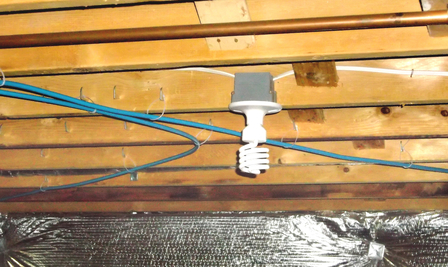

I got lucky and nabbed a 100' bundle at a ham fest some 15 years ago and it just sat in my basement. I was using a cable I obtained from the Boeing Warehouse in Everett, Washington that I could not part with for some 20 years. I have tried many "audio" cables and the Boeing stuff was always the cable that served the music in a good way. Then I looked the Heliax through "new" eyes and did a temporary trial with alligator clips. HOLY CRAP!! It wasn't even a contest! So I terminated a pair -- and as Paul Ellicott said -- they are special. A buddy of mine has had the same experience. :thumbup:
I terminated them with male Silver PL-259 connectors and attached female PL-259 connectors to the floor of my living room at the amplifier and speaker ends. I run the cable under the floor. What can I say? I like things neat. The female is terminated with 8-inch twisted pig-tales up through the floor to the amps. and speakers.
So -- you could say that my house is now actually part of my audio system. :crazy:
Working with Heliax is another pain-in-the-ass. A thermal stripper, a plumber's copper-tubing cutter, together with a 250-watt vintage soldering iron gets the job done. You will not be able to solder with a soldering gun. You need some serious Btu's to overcome the heat sinking abilities of the copper-tubing shield and silver connectors. The big-ass iron will pump plenty of heat for good solder flow.
