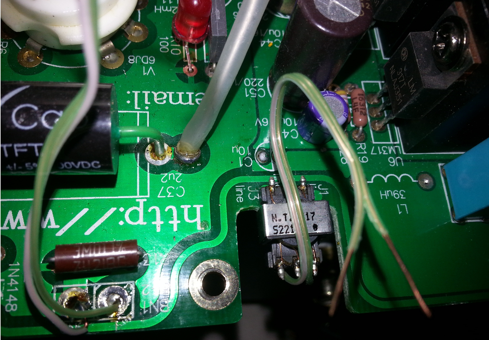

Roscoe, HAL, if I understand correctly, the CS8414 serves to change the S/PDIF (in my case the balanced version) to the I2S protocol?
The DAC chips are BB PCM63. There are two other on board chips.
I don't have a super clear schematic. The DAC 60 is similar to my DAC 50, may be more legible.
Pictures are attached from when I replaced the Toslink input with a transformer, per Crystal's data sheet on the chip, to allow balanced input. Attaching both schematics. Will have to do multiple posts due to file attachment limits.

The I2S lines are pins 11, 12, 19 and 26. It appears that everything prior to that is associated with the 8414 and can safely be removed.
Ideally, I'd like to leave the S/PDIF and AES/EBU inputs in place and be able to switch between them and USB.
Can I simply cut traces, insert a switch or switch controlled reed relays, and add the USB/I2S interface?
