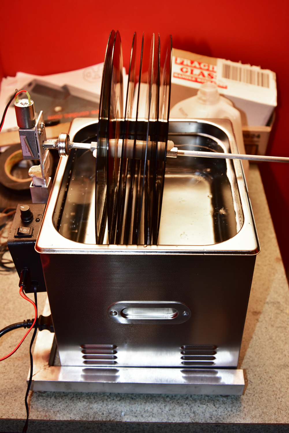

after a demo of how well theses things clean LP and not wanting to spend $1500 or more I decided to assemble one since the price of the tanks have come down so much recently.
I paid $146 with shipping from Ca. another $100 for motor/controller, bits of aluminum from Home Depot. I still have the filter to add, just need one more coupling to get it together. So my total investment so far is about $250

What size tank did you use?

Its a 10 litter.
The spacers I am using are just 1/2 inch which may be a bit too small. 3/4 to an inch seems to be what most use but I was trying on this first version to go as cheap and easy as I could and the nylon spacers were very cheap.
There are more versions for the cleaning solution than one cares to read, but most are various ratios of distilled water, isopropyl alcohol, and photo-flo

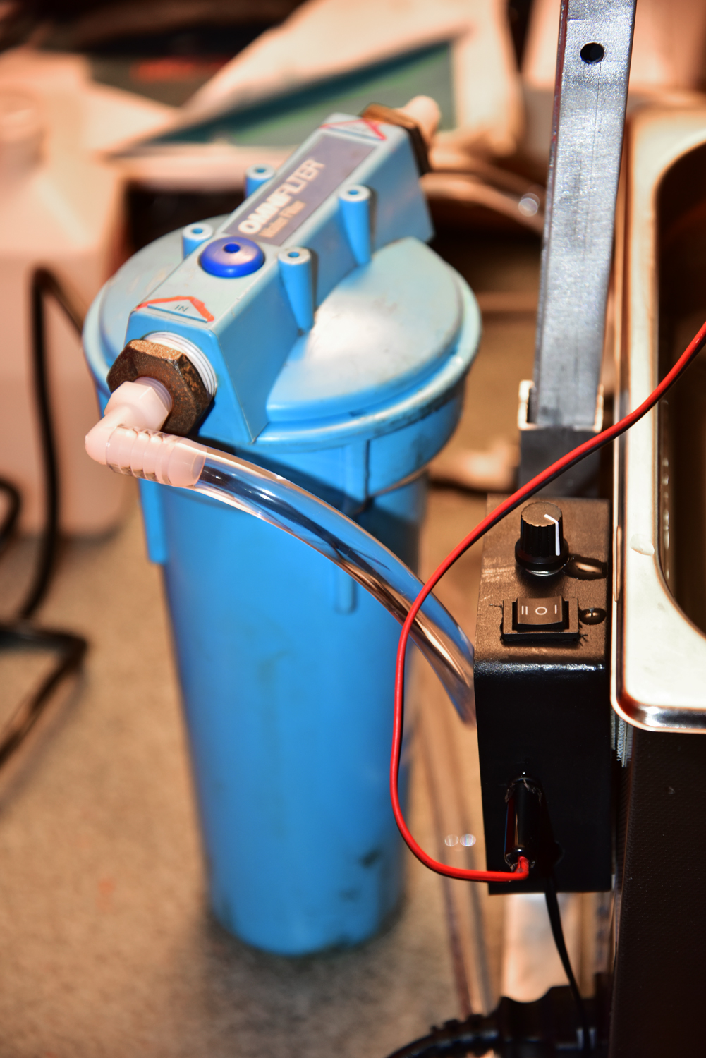

I added the pump and filter. I will probably be flamed for the filter. My goal was to hold cost down and I already had the filter canister on the shelf. I can get a pair of 5 micron filters for less than $10 at home depot. I use them for my whole house filter system so they were on the shelf also.
What the commercial guys use is an aquarium filter that cost between $100 to $180 depending on the number of filter stages and GPH. I could not find any specs on how fine the aquarium filter was, just marketing goop. My $20 pump claims 225 GHP, I believe I am getting a refresh in less than 3 mins. I am setting the temperature to 37C which is 68F, a throwback to my darkroom days.
