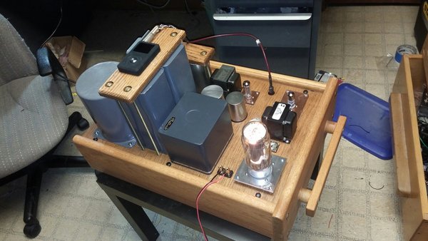

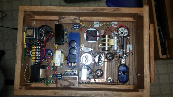

It has been a long time since I started, but I finally completed the first of two GM70 monoblock SET amps. The circuit is a simple two stage, interstage transformer coupled design, using an SiC diode biased E280F (7722) triode connected pentode voltage amp/driver, through a Hammond 126B 5K/5K interstage, to a cathode biased (for now) GM70. The power supplies are all-tube rectified, using oil capacitors and over-specified iron, with a B+ of 1025V for the GM70, and 190V (separate supply) for the E280F. The GM70 filament is fed 20V/3ADC through a Rod Coleman regulator. Based on the operating point, I figure I am getting around 20W in Class A, and due to using an interstage transformer, and go into A2 to the limit of the driver stage.
The B+ power transformer is dead cold when operating. It is a big UTC 1500VCT/1900VCT/300mA continuous duty unit that Grover donated, and after running a half hour or so, is still cool to the touch. Also using a big 10H/500mA choke, another Grover donation. The big oil capacitors are 88uF/1200V pulse capacitors (either paper/oil or PP/oil).

Outstanding layout and construction! Great job David.
 Post subject: Re: GM-70 Amplifier
PostPosted: February 18th, 2016, 10:01 am
Lovely work. Is the chassis a drawer? How heavy is the amp?
PostPosted: February 18th, 2016, 10:05 am
Cool heavy-@ss amp there, Sir!! Well done!! :handgestures-thumbupleft: :handgestures-thumbupleft:
I am not confident that that puny wood handle can bear the strain, however!
Looks like a carbon plate GM-70. See if you can snag a comparison pair of the metal plate units which I thought were more open sounding, a somewhat different flavor, but the carbons do a nice fat "run you over" presentation in their own right.
I'd expect that this is a powerful sounding machine indeed!
Is that a fan on the Coleman reg? I believe these things get quite hot, no? Rod's instructions seem to prescribe lots of heatsink.

I have a pair of copper plate GM70s on the way from Ukraine as we speak. I have a healthy heatsink on the Coleman regs, which I have tested and it keeps pretty cool, around 50C in operation according to my IR meter. No fan.
The sides of chassis is built out of oak stair tread (1-1/8" thick), the top is 3/4" oak plywood, poplar core. You can probably park your car on top of it. Figure the entire amp weighs around 70 lbs.
