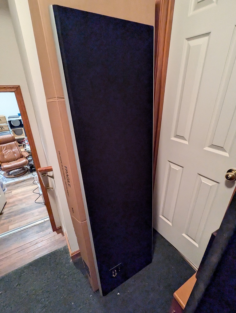

Magnepan 1.7 pair #2 have the silver side stiles as compared to pair #1 with the black side stiles.
Now to remove the sock and passive crossover and install the replacement wiring and connector plate.

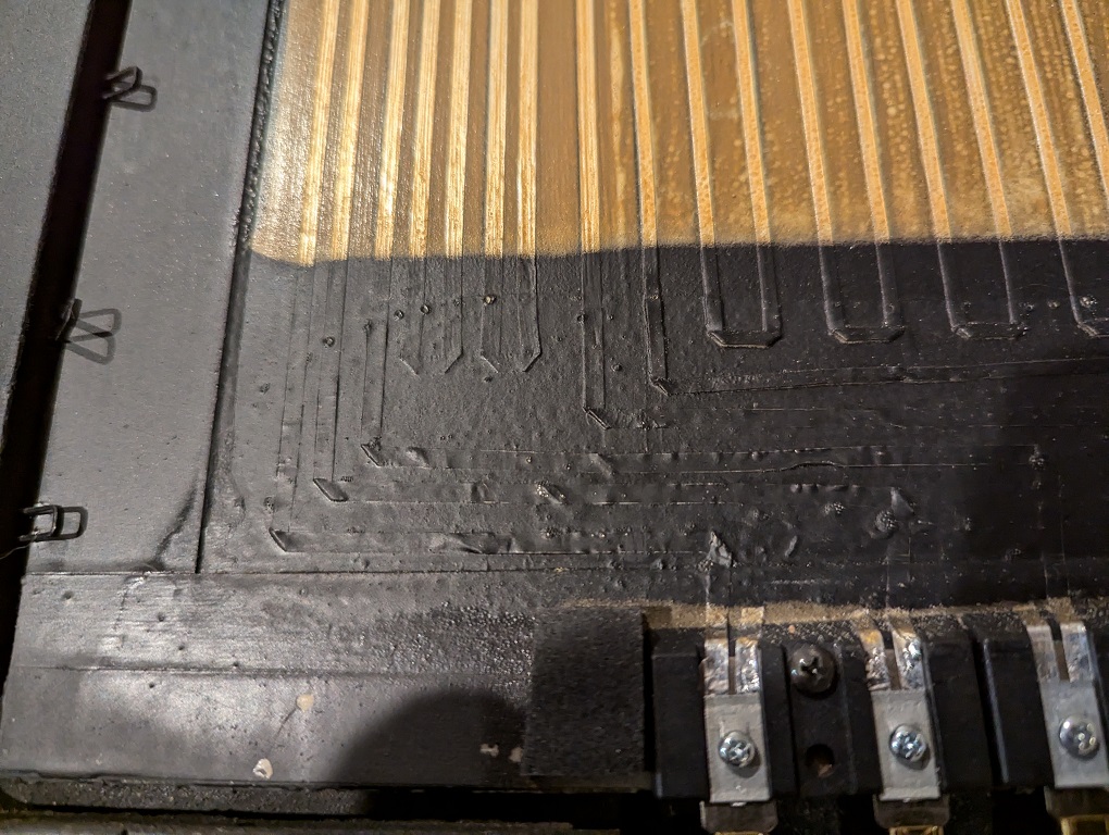

Now that CAF2024 packup is completed, time to go back to the 1.7's to see if I can find the break in the foil.
Wired up a 12VAC toroidal power transformer to a 250Ohm resistor. Wired the resistor to the positive side of the foil. Only using the inphase lead of the toroid with my ELFIX to see where the AC field stops along the foil path.
The foil break seems to be at one of the folds close to the negative terminal of the supertweeter. Will use some acetone to remove the paint and glue to inspect the fold.
Purchased some grounding paint that is carbon based to see if it will complete the foil circuit. I thought about silver, but that and aluminum are not a good combination, so the flexible carbon paint might work. If I paint the carbon trace first, I do have some silver conductive paint that could go over the carbon to increase the conductivity, but not directly contact the aluminum foil.
I do have a ribbon replacement kit from Magnepan, but that is not an easy project from watching the Magnepan LRS build video on YouTube.

Since this foil is directly on the mylar film, do not want to take any chances in melting the polyester.
Found something possibly better. Flexible nickel adhesive is compatible with aluminum, so have a small pen of that coming.
Need to take it outside to use the acetone to remove the paint and cover layer over the foil for the repair.
