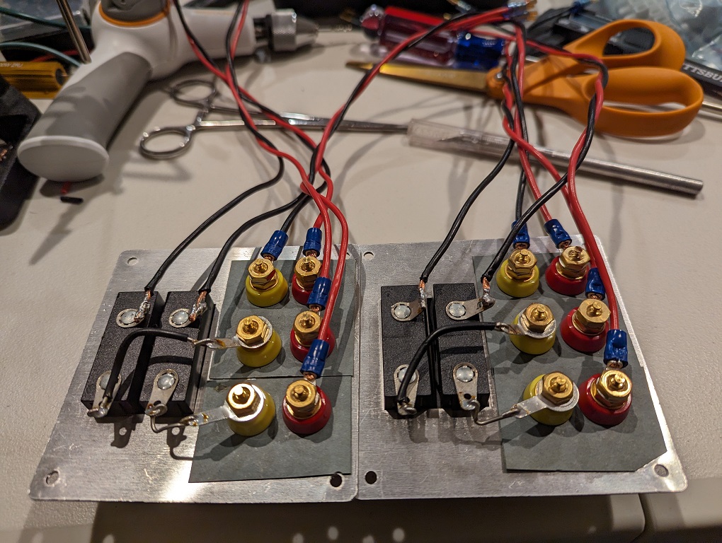

New connector plates wired for 3-way use for the Magnepan 1.7 speakers.
Disconnected the original passive crossover in the 1.7's and will install the new connector plate in the speaker with the open super tweeter for testing.

Both 1.7's have been modified to use them as active 3-way planars. Removed the passive crossover boards and wired up a the new 3 pair 5-way binding posts directly to the 3 planar drivers.
The right speaker is the one with the open circuit super tweeter quasi ribbon. That will be a good weather project as it needs acetone and isopropanol to clean off the glue to remove the old foil. Use Super77 spray glue to attach the new foil and rewire the connectors.
