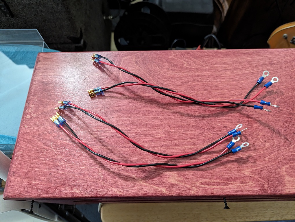

PostPosted: June 23rd, 2023, 7:01 am
Posts: 906
Have the 8-Superior Electric 5-way binding posts coming soon, so made the wiring to go with them.
Will just store the original wiring in the back of the speaker with the picture for future use if needed.
