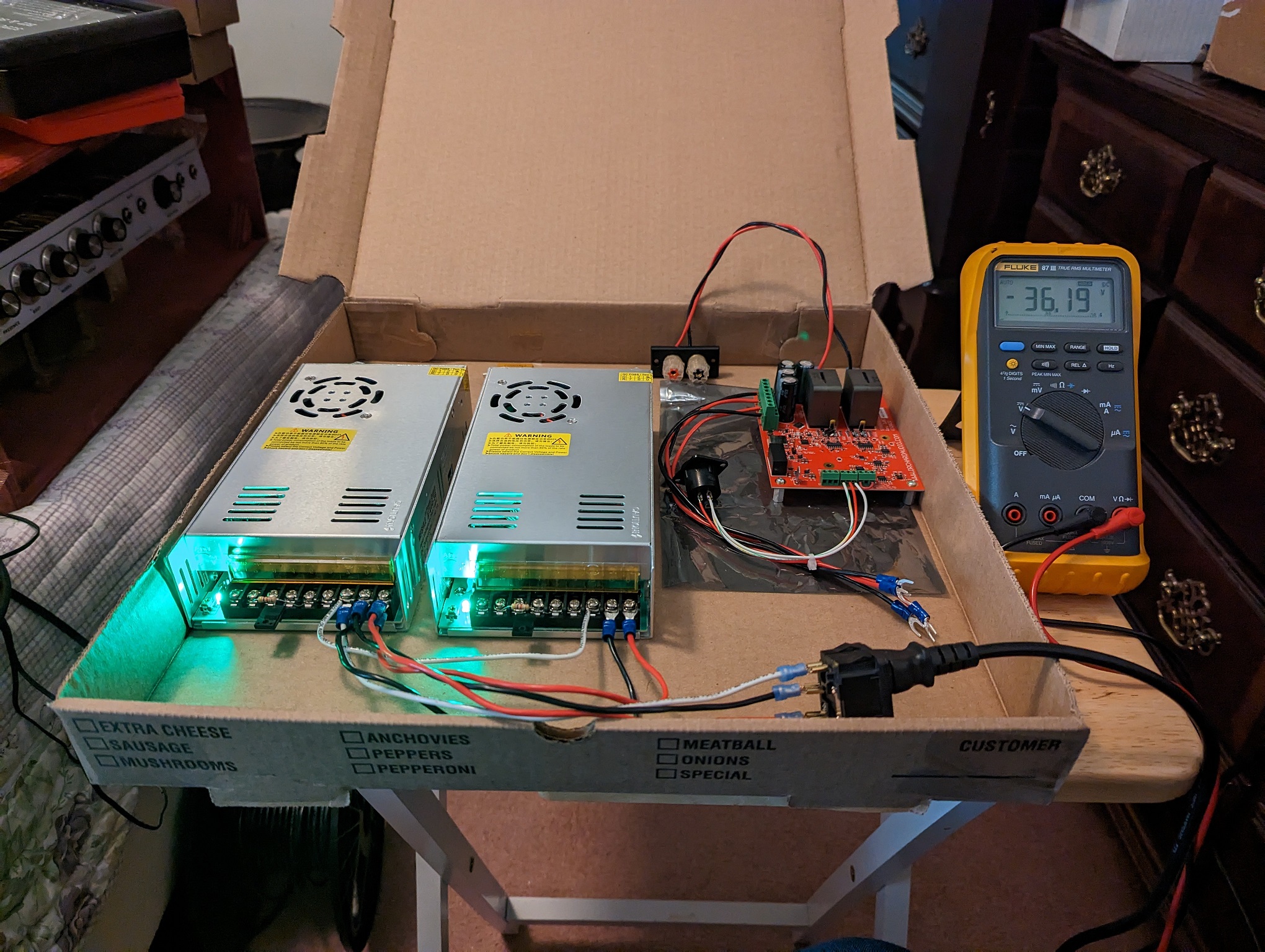

The SMPS to try. They are rated at 36VDC at 600W each for the +/-36VDC power supply and adjustable output voltage over a small voltage range. Yes, that is 1200W total power supply per module. Should be no problem for the 500Wrms into 4 Ohms rating for the amp modules.
Picked up the rest of the connectors today and the second pair of SMPS arrive tomorrow for the other amp module.
In the first test with a light load, both AC inputs tied together did not have a problem with a T5A slow blow fuse for startup. Will keep these as they will shut off the amps if to much current is drawn. A simple way to get started.
Will try a 100Ohm 25W resistor per SMPS tomorrow to try about 0.36A current load to see if they are stable and low noise with my o'scope.

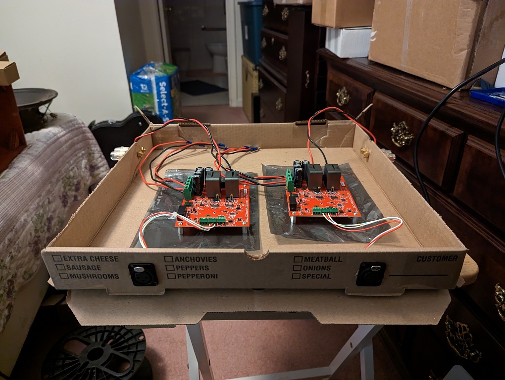

Have installed the input and output connectors in the box for the 2 channel amp.
The Pizza Box Amp +/-36V@16.7A SMPS ready for wiring to the amp modules. Using 14awg stranded Belden 1309 cables for the DC power.
Will add a capacitor bank to the amp module pizza box to lower the impedance at the amp end and help filter any SMPS noise further.

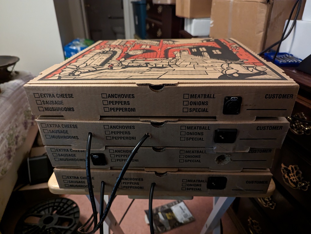

The monoblock versions of the Pizza Box Amp v2.0 are built.
Next it audio testing with an 8 Ohm dummy load to verify correct operation.

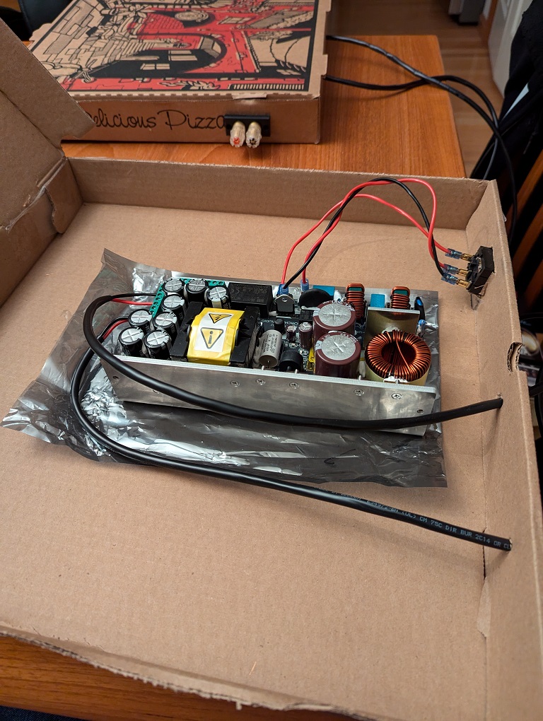

Not happy with the turn on current for the fanless SMPS, so ordered the Orchard Audio SMPS with on chassis soft start for the Ultra amp modules. They arrived awhile ago, but had other things to do.
Wired the first SMPS last night and the second this morning, but need two power switches that are on order. These are low current switches not in the AC line for amp startup.
