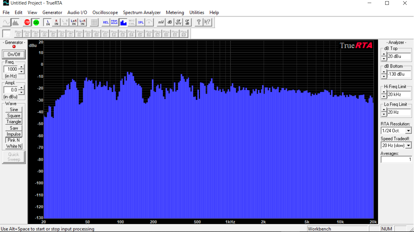

I use TrueRTA here are pink noise and sweeps of the RAZZ and Quad ESL. The RAZZ stock tweeter is not active. I added the ESS AMT Large which gives me a much smoother response.

Volti Razz full 20 to 20k pink noise
Quad ESL full 20 t0 20k pink noise
