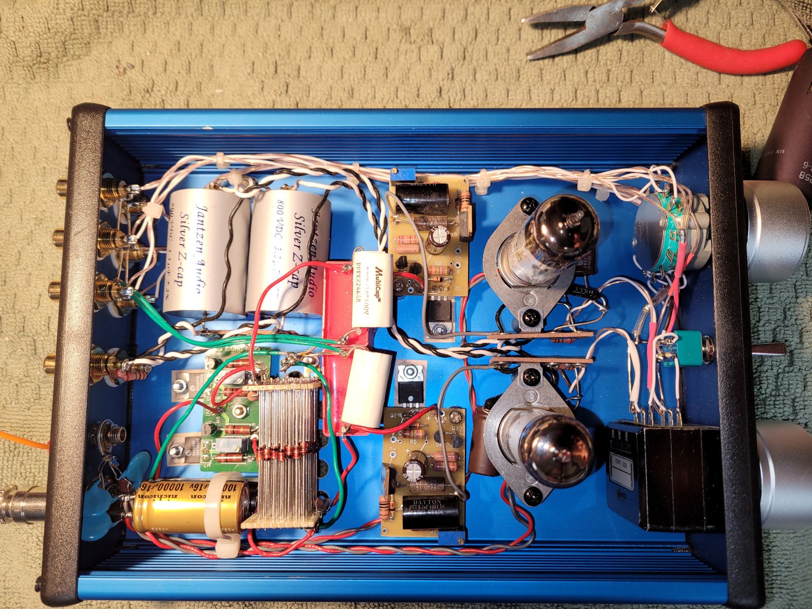

If sometime you want to hear what a 12B4 linestage sounds like, I just dug out the linestage I built a while ago that ended up having a regulator issue that I finally tracked down this afternoon. I am using Morgan Jones' "Statistical Regulator", which is a current source fed shunt regulator consisting of a series string of 5.6V Zener diodes. Ended up I had 2 bad zeners in the string on one channel, so replaced them and the regulated supplies for both channels work. I did have it jury-rigged to just use one regulator shared between both channels, and it worked OK, but was worried about the current through a single series string of zeners (40mA) so put the preamp away for a while.
BTW, this preamp has CCS loading for each 12B4, with a cathode resistor and ELNA Silmic electrolytic bypass capacitor. Anyway, I have it in my basement near field system and it is sounding very good driving a pair of Pass AmpCamp SE Mosfet Class A amplifiers into my Aria 5R speakers and subwoofer. Definite improvement over a Topping A50s.
BTW, the power supply is a seperate box, connected via an umbilical.
