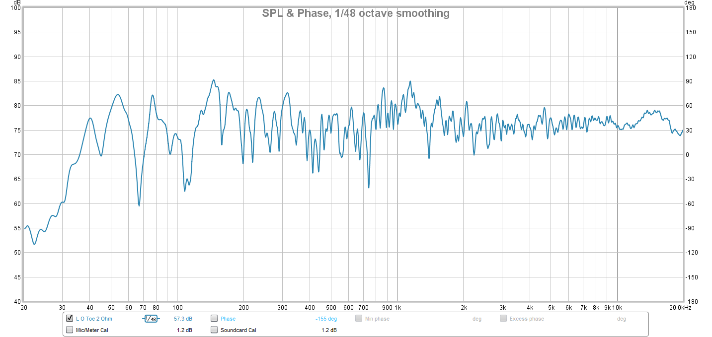

I finished building the crossovers designed by Dhar. He started with my original crossovers and made changes that solved two issues. One was the bump starting at 1kHz. This is actually the drivers and the bump shows up on their spec sheet sweep. The other was flattening out the tweeter. Here are two sweeps from the listening position. The impulse window is wide open so you're seeing room influence, not just the speakers. Also, this is just the top box, no bass cabinet involved.
The original crossover:
The new crossover:

Yesterday, I spent sometime at Dave's. My take on his system:
Couple of us were concerned how well a 7" ribbon tweeter integrates in MTM configuration. It did integrate very well, there were no anomalies from the listening position.
The MTM system is very good overall. It images very well, vocals are very good and the highs are detailed and sweet.
In his system, the comparison between active and passive configuration is not valid as they are differently configured. In the active configuration, DEQX processor is used as active crossover. DEQX is limited to 96kHz bandwidth. So, Dave is feeding 96kHz upsampled material from foobar to DEQX, which divides the frequency ranges into highs and lows in digital domain and sends the data to 2 Spring DACs via SPDIF.
Holo Spring DACs are very good. We talked about the DAC and switched to passive crossover. This time, at my request Dave configured foobar to upsample to 384kHz and feed one Spring DAC via USB. The difference was immediately noticeable. Background became silent. We did not do detail comparison, but the obviously evident background noise is enough to convince me that using DEQX is not a good idea in a quality audio system. It was limiting the virtues of Spring DAC.
Then Dave switched the passive crossovers and the mids/vocals became cleaner and the bass seemed to become tighter. Later Dave revealed this crossover is designed by Dhar where he fixed 1kHz bump and treble. Dhar did a very good job with the crossover.
