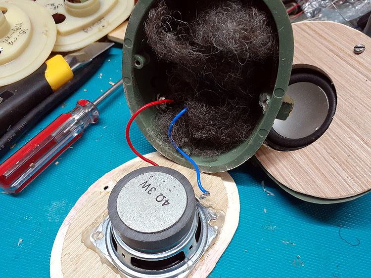

The drivers in the foreground are the originals just behind them are the new ones mounted in 1/4 inch ply baffle boards
the 1/8 deep 1/4 inch wide rabbit around the edge so it would fit into the original cup was an interesting exercise in not getting my fingers ripped off at the router table.
