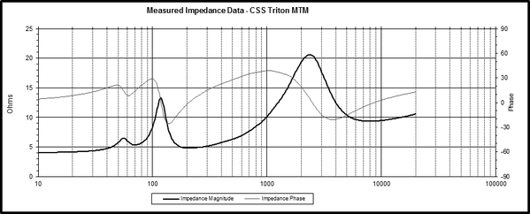

Bagby Triton's - possibly- can't find impedance but well reviewed - http://meniscusaudio.com/triton-pair-p-1346.html
Triton's have a lowish impedance, due to the parallel woofers... see attachment.
