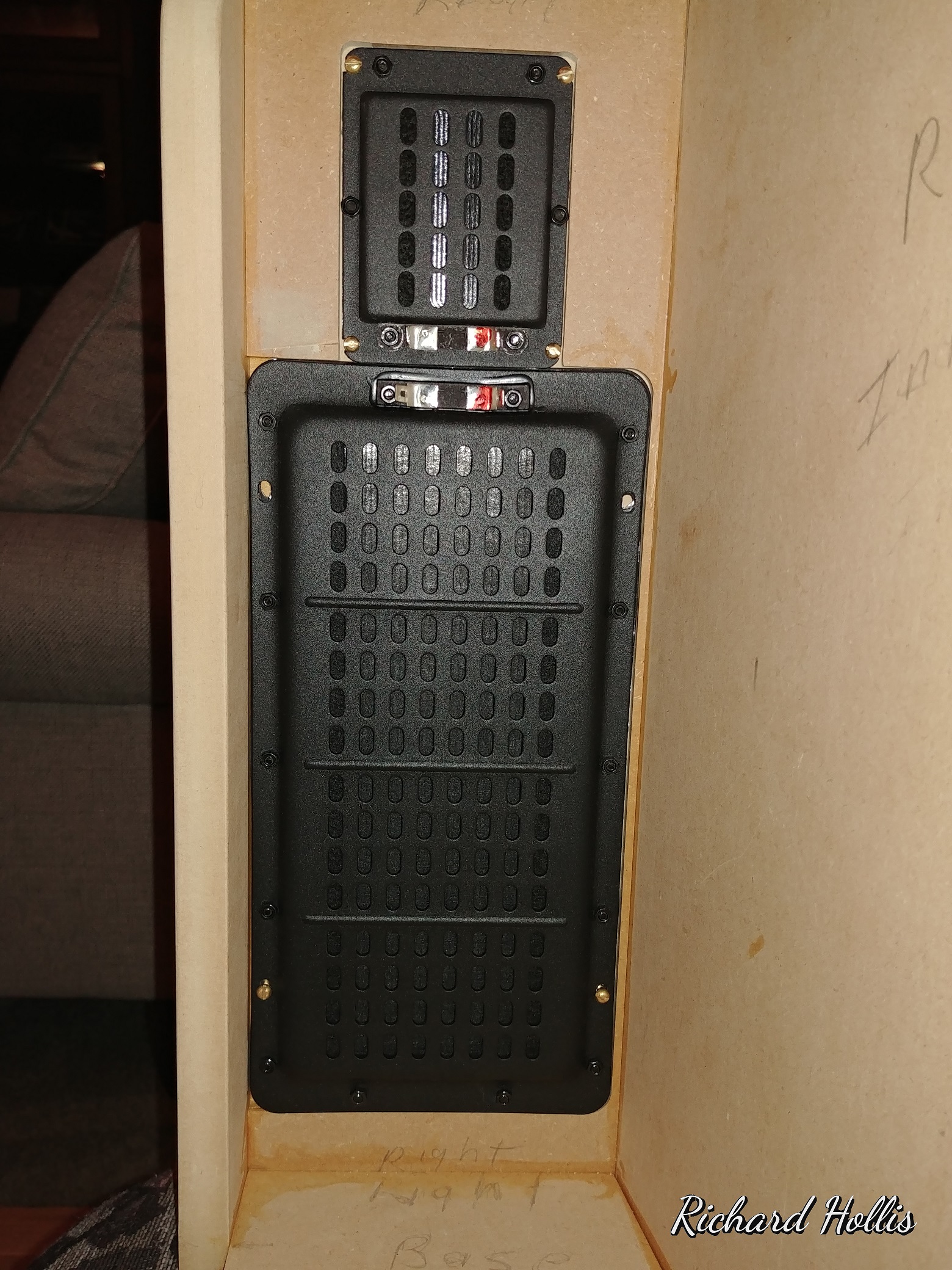

An asymmetrical wing works well with the BG drivers to keep the LF response and give really nice imaging with the small frontal area.
Here was my test fit of the GRS 3" and 10" planars in my existing open baffles for measurements.

Posts: 1185
I don’t consider that a “wing”. You have a half enclosure to avoid room reflection. A wing for me means a baffle. I read Toms statement to mean baffles of rich and left speakers are not identical.
