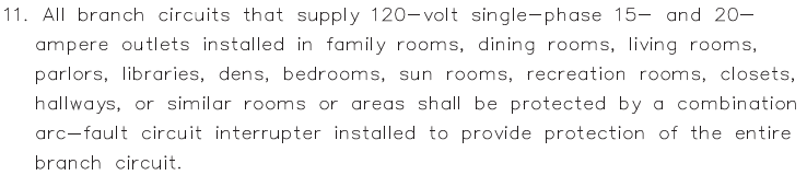

Here is the spec for "breakers" in my new house under construction. As you mentioned they are arc fault interrupters that look for high frequencies on the line caused by arcing.
Yes. That's the current code requirement and has been in effect since 2015.

I spoke to a couple of electricians who said certain appliances like vacuum cleaners drive the arc fault suppressors crazy. One of the electricians said when working on new construction where contractors are using saws with electric brakes, he installs regular breakers while they are working or the interrupters would trip repeatedly when they stop the saws. When they are finished he goes back and replaces the standard breakers with interrupters. They are another case of good ideas with unforeseen consequences.
I get that. The motor commutators!! Who knew?

I spoke to a couple of electricians who said certain appliances like vacuum cleaners drive the arc fault suppressors crazy....
I just experienced this with our recent remodel. Had to clean the vac motor and install new brushes, which improved it 90%, but there's still a circuit we have to avoid using. It's definitely the vacuum too. I can plug in my shop vac or any other tool into that circuit without a problem. Plug in the house vacuum and it trips.
As Tom said, a real good idea that just came up a little short.

Yeah, we detest arc-fault breakers, both series and shunt type cause unwanted nuisance tripping and play havoc with some older installations. Some AHJ are demanding AFCI be installed on all circuits when a heavy-up is performed. That's not a NEC requirement, but it is their prerogative.
