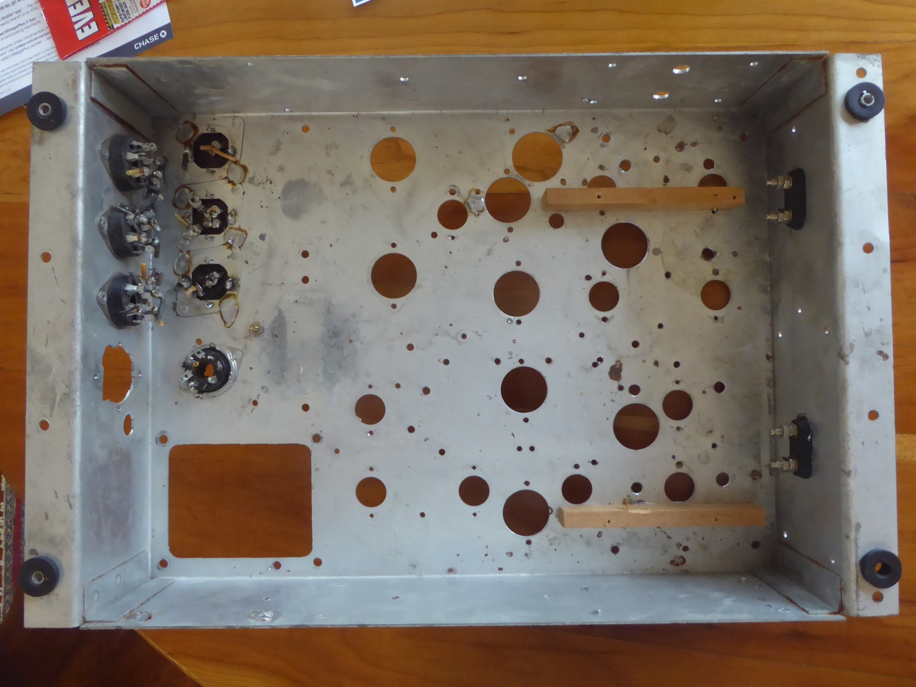

Here is a photo of the chassis. I am wondering where I can find some room for more holes since I obviously don't have enough of them.

Reminds be of a 1960s and earlier small aircraft instrument panel. We used to call them "shotgun" panels (before the "sacred six"). Looked like the manufacturer fired a shotgun at the panel. Wherever there was a hole, they installed an instrument or gauge.

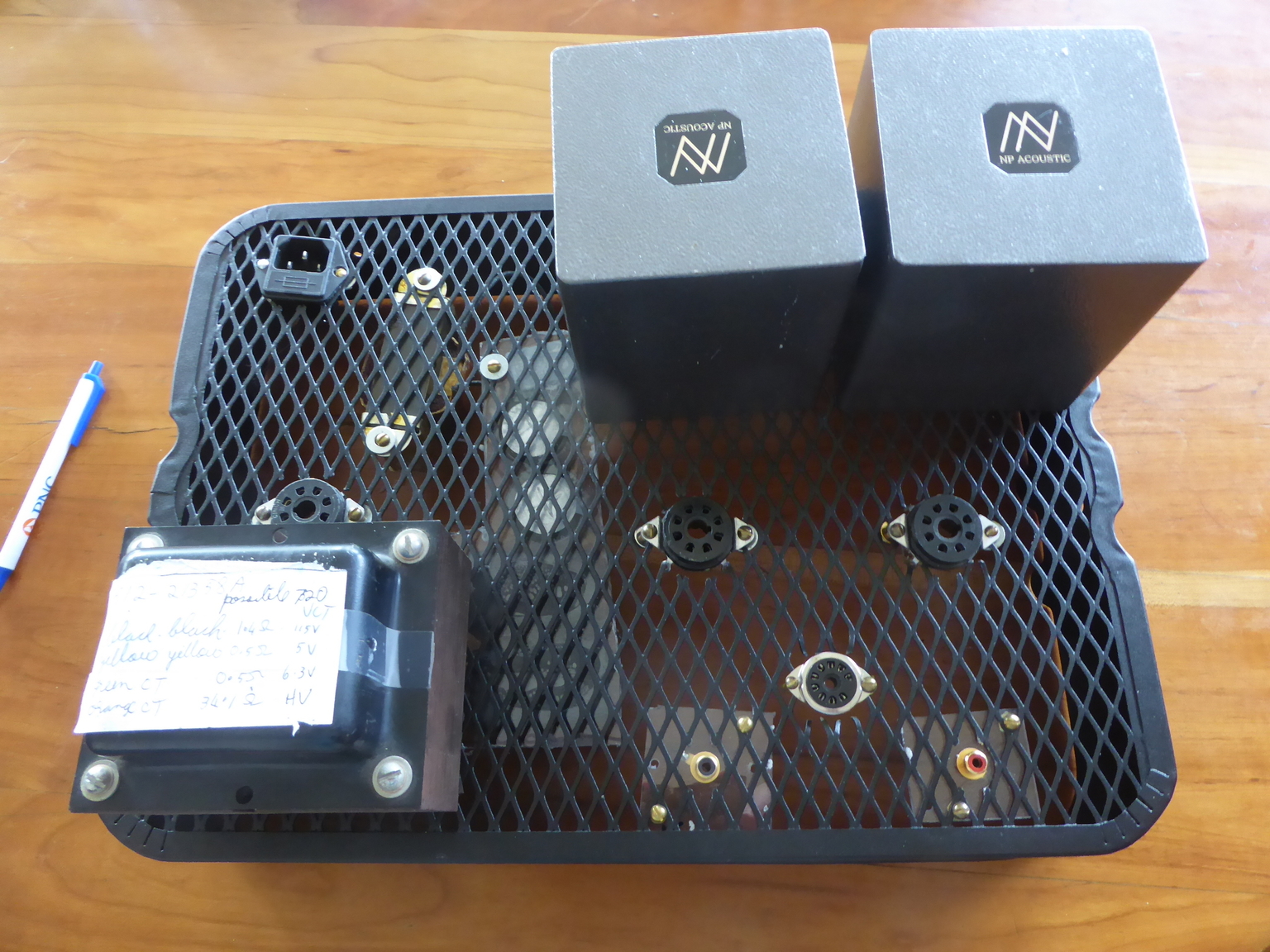

There has been some slow progress on my Corona amplifier. I limit myself to a few minutes each day since I suspect we will be in isolation for quite a while. I am also slow since I don't have most of my usual tools etc.
I have remounted the power transformer and also mounted the two output transformers. They are 5K NP Acoustic SE amorphous core from Hanoi in Vietnam - NP5SE18F60. I bought them in Australia a couple of years ago but was unable to use them because of my illness which made building too difficult.. They are supposed to sound pretty good.
http://npacoustic.com/en/product-and-price
I have mounted them on wooden strips because I had trouble lining up holes for the wire connections. You would think that I had enough holes!

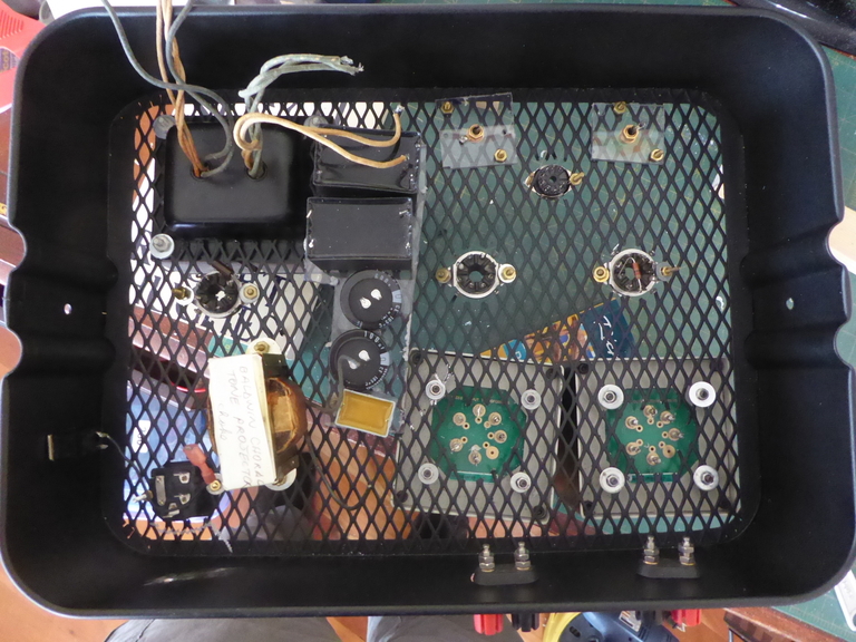

Ikea still had the black Raskog trolley available so I ordered one. Since I was curious to find out what it would be like to actually build with one of the trays, I have transferred the components to one of them.
I was hoping the mesh would allow me not to have to drill too many holes but invariably the components don't line up too well. The tray is strong enough to hold the components but I suspect it will ring unless I apply dampening material. So far, the amp weighs 25 pounds which I can lift quite easily now. Hallelujah!
No wiring yet. I continue to do just a little every day as a treat for myself. Since most of my usual tools are packed, it has been a bit difficult to do some things and the experience has given me some food for thought. It will be interesting to hear how the amp turns out. The input tube will be a 5687 and the outputs are 6550s.
