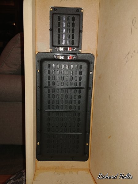

Here was my test fit of the GRS 3" and 10" planars in my existing open baffles for measurements.
 Post subject: Re: GRS Planar Drivers
PostPosted: October 17th, 2020, 8:01 pm
Posts: 1201
I don’t consider that a “wing”. You have a half enclosure to avoid room reflection. A wing for me means a baffle. I read Toms statement to mean baffles of rich and left speakers are not identical.
