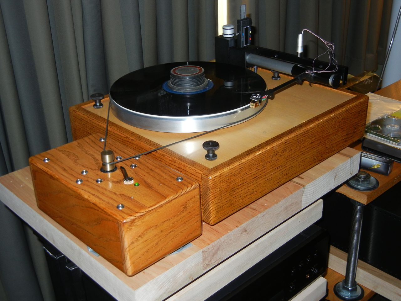

Introduction
As a member of a DIY club, I was inspired by other members’ projects to present my own project. Other club members had built turntables, and I thought I’d try. However, I didn’t have access to a machine shop, so I had to find other ways to get crucial parts, namely a bearing-and-platter assembly and a respectable tonearm. Internet searches turned up a manufacturer that provided platter-and-bearing kits, and another manufacture that produced nice-looking tangent-tracking tonearms. This article describes how I built a wooden plinth, a motor enclosure, and an air-supply system to combine those two subassemblies into a turntable that performs better than a commercial turntable that costs the same as my investment in the project.
File comment: Figure 1: The Finished Turntable with Outboard Motor Pod
