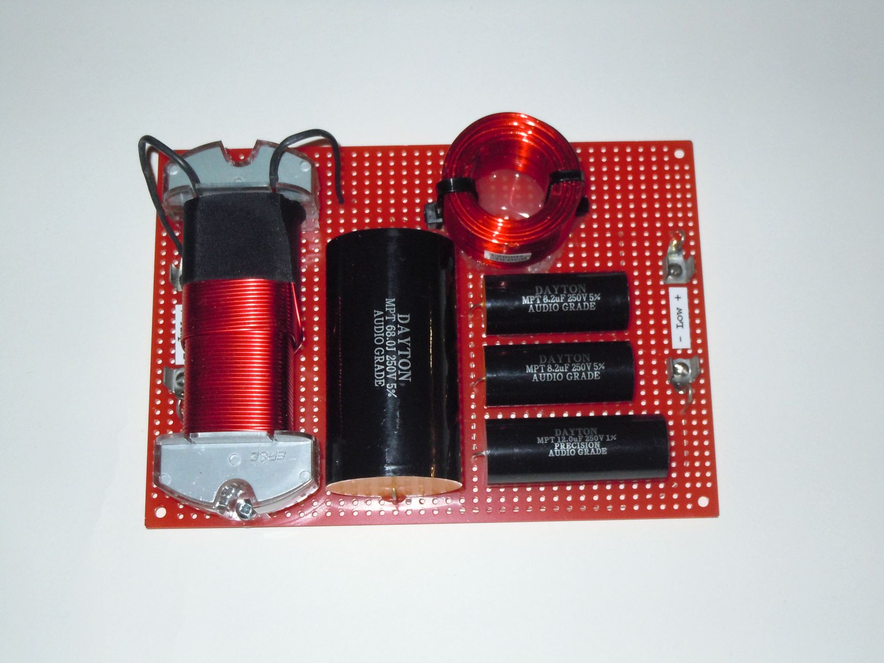

I used these boards from PartsExpress for the passive crossovers for the "eggs".
https://www.parts-express.com/White-Per ... -7-260-190

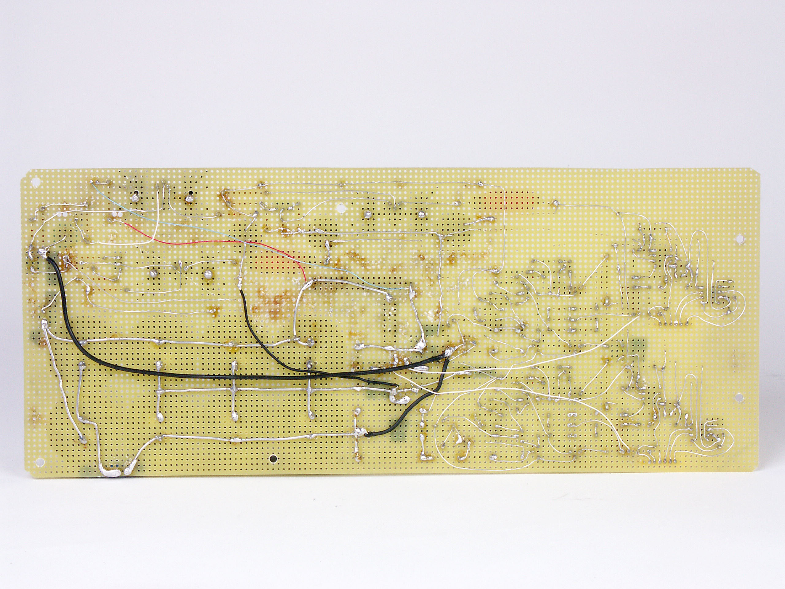

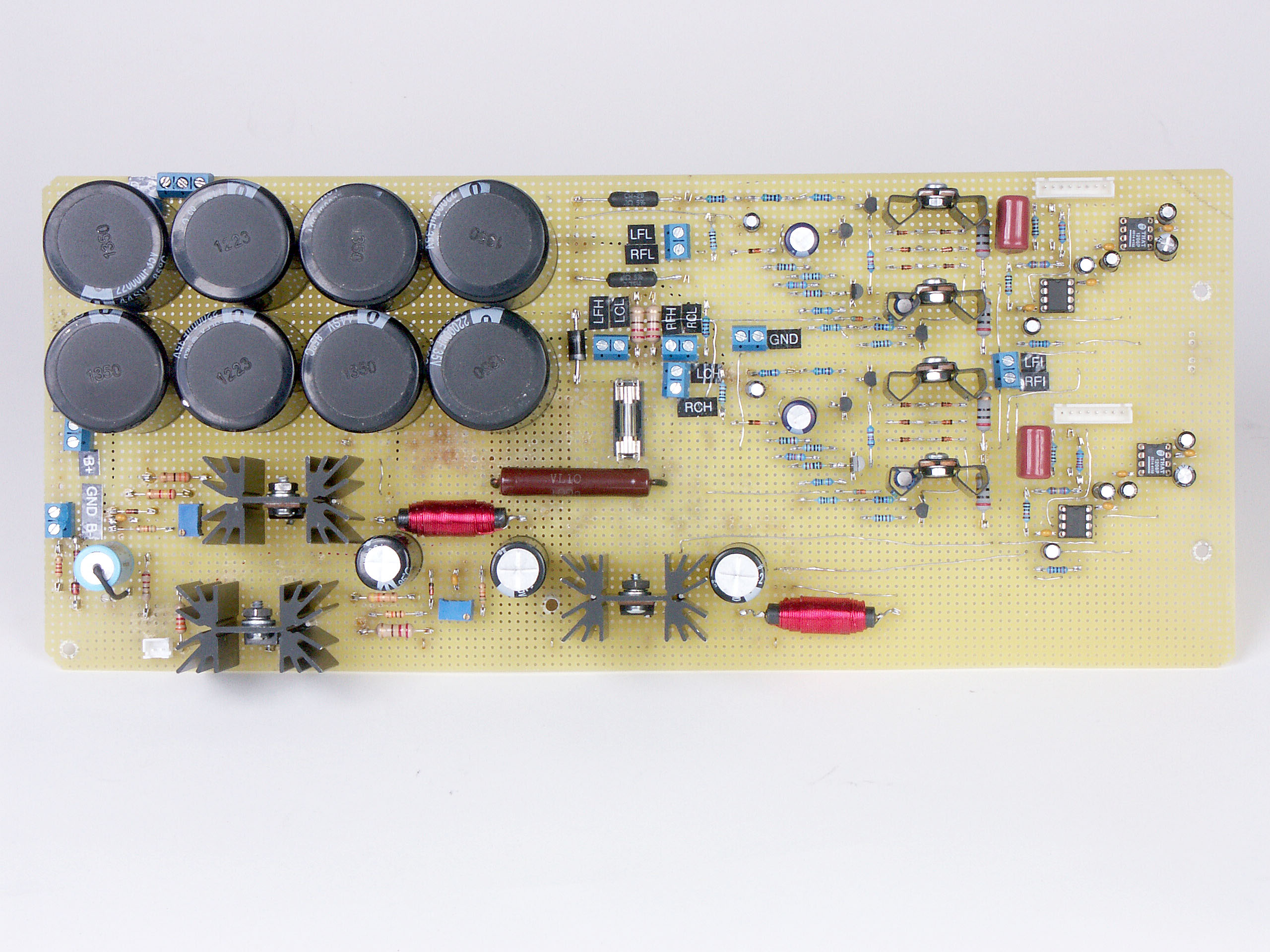

When I am working with any board material that has holes, I insert the component leads through the holes and then wrap them with the appropriate sized buss wire. Here are photos of the top and bottom of the "Cherry Bomb" amp where you can see that technique. The wire layout is similar to what you would have with a PC board, but is much more flexible than a PC board.
