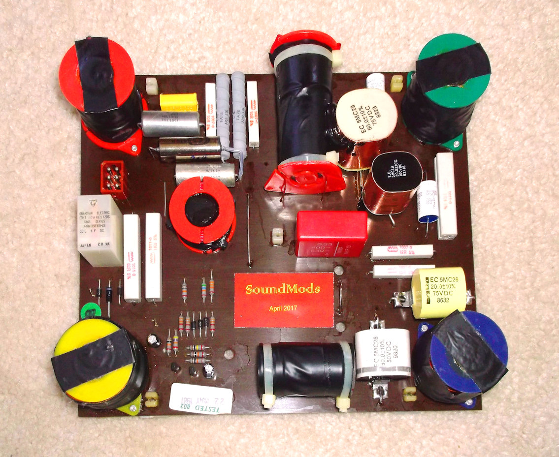

Attached are the photos of the upgraded crossovers. You’ll note that all but two capacitors were exclusively polycarbonates (ear-tested for the project) with hermetic Teflon bypass caps in the tweeter networks and WIMA polypropylene used as much reduced value shunt in the mid-range networks. You will note the small form factor Electronic Concepts caps designed for Mil-spec switch-mode power supplies and glass hermetic polycarbonate and Teflon caps designed for only God knows what. And my favorite tweak is the use of clamping resistors on each every capacitor and inductor to assure that those resonant reactance’s do not have snow-ball’s chance in hell of enabling those resonances.

“The next operation required was my B&W 802 Series 80 speakers from 1981 which have some renown from the Matrix series. I knew they were good in their day, beautiful solid cabinetry and high quality drivers, plus the midrange heads had been upgraded to make them 802F's now. They just weren't producing what I believed was possible. So, I shipped just the crossovers to Walt, and he replaced the critical components and added a few of his own. With his half-century of experience, he figured out a way to avoid the pitfalls associated with these upgrades. The speakers are finer than "new and improved" models that are more sizzle than steak. Hearing my system is thoroughly gratifying because of Walt's intervention. If you have audio components that have lost their luster, Walt is the man who will restore and improve them. You'll also get a detailed, bound account with photographs of the operation. He's rabid, alright!”

Can you explain in a little more detail the concept of clamping resistors?

Hi Chris! Whenever you have a capacitor and coil in series or parallel you end up with a reactance that acts like a "tuned" circuit that resonates. These resonances drove me crazy some 20-years ago when I was dialing in a pair of speakers. When I did the math, the combinations created the very issues that I believed were mechanical. WTF?! So going back to basic electronics theory I decided to try to prevent those resonances from occurring. It worked. When Dave Wilson and I first discussed the damping resistor scheme he poo-pooed it. Then two weeks later I get a call. He put one his crossovers on the the bench, installed resistors, and he remarked how the ringing issues he was trying to get rid of stopped. He used signal pulses and a scope to watch the results. He gifted me with his Wilson

. . . You’ll note that all but two capacitors were exclusively polycarbonates (ear-tested for the project) with hermetic Teflon bypass caps in the tweeter networks and WIMA polypropylene used as much reduced value shunt in the mid-range networks. You will note the small form factor Electronic Concepts caps designed for Mil-spec switch-mode power supplies and glass hermetic polycarbonate and Teflon caps designed for only God knows what. And my favorite tweak is the use of clamping resistors on each every capacitor and inductor to assure that those resonant reactance’s do not have snow-ball’s chance in hell of enabling those resonances.

First off, where do you get the EC caps? I noticed a few for sale on ebay but otherwise they seem hard to get. EC does have a website and I gave them a call but they're not particularly set up for small buyers. Their price for new caps in small quantity was really high even by audiophile standards.
Second, I'm curious if you have any rules of thumb for the clamping resistors. I would imagine that one just takes the impedance of the cap or inductor at the crossover frequency and multiplies it by ~100x and that would take care of it. From the pictures, it looks like you use 470 ohms a lot with the occasional 5K ohm thrown in there.

There was time -- long-long-long ago when Electronic Concepts dumped their out-of-tolerance production and the New Jersey sales office sold them for the manufacturing cost.
The DYI guys that new about it called it the "Candy Shop." That's done and gone now. Maybe the question to ask is what do they do with out-of-tolerance production? It would be sin to throw them away. :o
The caps you saw in the B&W crossover were scooped up from eBay. I keep a constant watch -- but I haven't seen any for some time. There are plenty fo that style in polypropylene (the EC model no. would have MP in the number as opposed to MC)
There are hermetic polycarbonate caps out there -- not EC -- but damn good. I have some large values that could be used in crossovers.
My original testing about 30-years ago (when I figured out what was going on) I determined an ideal 350-ohms across capacitors and 500-ohms across inductors.
Since then I found that it is not critical but you do not want to go lower than 350-ohms across caps or lower than 450-ohms across inductors. There were no 5-Kohm resistors used in the B&W. The gray silicon wire-wounds were actually 350-ohms. The "5" was part of the part number.
