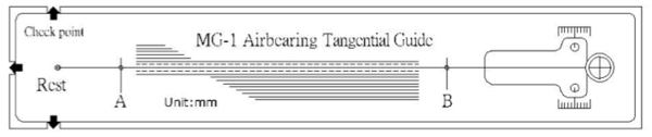

There was an initial setup to align the tonearm to the platter. The cartridge was attached to the head shell of the tonearm wand. The tonearm should not be moved on the air beam without air applied, so the pump was plugged into the wall, and the black tonearm air sleeve was slid onto the silver air beam. A retainer screws onto the end of the air beam to keep the tonearm from sliding off. This feature also allows the user to buy another tonearm and quickly exchange cartridges. A tracking force of 1 – 2 grams was placed on the cartridge, and one of the templates provided with the tonearm was put over the spindle on the platter (see Figure 28).
File comment: Figure 28: The MG-1 Airbearing Tangential Guide Template (Courtesy of Ada Lin)
The template was rotated until it was about parallel to the air beam, and the tonearm was moved above the template to see if the air beam was truly parallel. With the air-beam assembly snugged to the plinth but not tight, the air-beam assembly was rotated until the stylus followed one of the parallel lines on the template. This indicated that the assembly was parallel to the desired stylus path.
Because the stylus was not tracking on top of the line running from the spindle to the “Rest” point, the wand retaining screw was loosened (with a hex key provided by the manufacturer) and the wand was extended until the stylus tracked the line. The cartridge vertical angle was set by lowering the cartridge on a mirror on the platter, and making sure that the stylus showed no angle to the left or right. If an adjustment was needed, I loosened the same wand setscrew and rotated the wand. Afterwards, the setscrew was snugged down.
With the plinth hanging over the edge of a table so that the tonearm mounting screw was accessible from below, a bubble level was set on the platter, and the three spikes were adjusted to level the plinth. The tonearm level was then prepared for adjustment by first adjusting the counterweight until the tonearm had neutral balance (no weight on the cartridge). Because the tonearm level was more sensitive than the plinth balance, the tonearm drifted toward either end of the air tube. I used a 4-mm hex wrench to adjust the three leveling screws at the back end of the tonearm assembly until the tonearm sleeve hovered in the middle of the air tube. The tonearm mounting bolt was snugged and the tonearm level checked again so the sleeve continued to hover in the middle. Small adjustments to tonearm level can be made without changing the mounting-bolt tightness. The tonearm-sleeve assembly was removed from the air tube so I could move the plinth.
The turntable assembly was next placed on a stable shelf with enough room to the left for the motor enclosure. The air pump and surge tube were placed on the right side of the room. Remember that the air pump can be moved to another room if it is too loud for the listening room. A bubble level was set on the platter, and the three spikes were adjusted to again level the plinth. The motor enclosure was then adjusted to be level at the same height as the plinth. The belt was wrapped around the drive pulley and platter, and the motor enclosure was carefully drawn away from the plinth to apply reasonable tension to the belt. The motor enclosure was turned on, and a strobe disk was used to adjust the platter speed to 33-1/3 RPM with a jeweler’s screwdriver through the left access hole in the enclosure cover.
The air pump was again plugged into the wall, the tonearm was slid onto the bearing tube, and the retainer was screwed onto the end of the air tube. A stylus scale was used to adjust the initial tracking force to 2 grams. Then I had people with experienced ears sit down and listen to vinyl played on the turntable, and give suggestions on VTA adjustment. The optimal adjustment was determined as time went by and more listening proved the setting.
