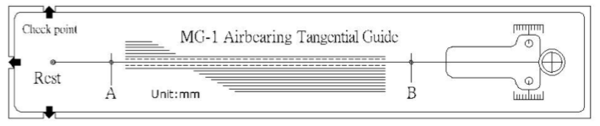

There was an initial setup to align the tonearm to the platter. The cartridge was attached to the head shell of the tonearm wand. The tonearm should not be moved on the air beam without air applied, so the pump was plugged into the wall, and the black tonearm air sleeve was slid onto the silver air beam. A retainer screws onto the end of the air beam to keep the tonearm from sliding off. This feature also allows the user to buy another tonearm and quickly exchange cartridges. A tracking force of 1 – 2 grams was placed on the cartridge, and one of the templates provided with the tonearm was put over the spindle on the platter (see Figure 28).
File comment: Figure 28: The MG-1 Airbearing Tangential Guide Template (Courtesy of Ada Lin)
The template was rotated until it was about parallel to the air beam, and the tonearm was moved above the template to see if the air beam was truly parallel. With the air-beam assembly snugged to the plinth but not tight, the air-beam assembly was rotated until the stylus followed one of the parallel lines on the template. This indicated that the assembly was parallel to the desired stylus path.
Because the stylus was not tracking on top of the line running from the spindle to the “Rest” point, the wand retaining screw was loosened (with a hex key provided by the manufacturer) and the wand was extended until the stylus tracked the line. The cartridge vertical angle was set by lowering the cartridge on a mirror on the platter, and making sure that the stylus showed no angle to the left or right. If an adjustment was needed, I loosened the same wand setscrew and rotated the wand. Afterwards, the setscrew was snugged down.
