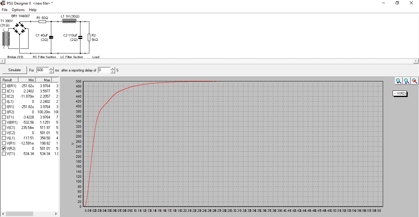

Using solid state rectifiers will result in about 500 volts using the same R, C and L values.
You can do all of this simulating easily yourself and play to your heart's content. Download and install PSUD at
http://www.duncanamps.com/psud2/
There are some tutorials out there, but start off by trying to duplicate the diagrams already shown.
PostPosted: July 16th, 2016, 3:30 pm
See attached file for the solid state version.
