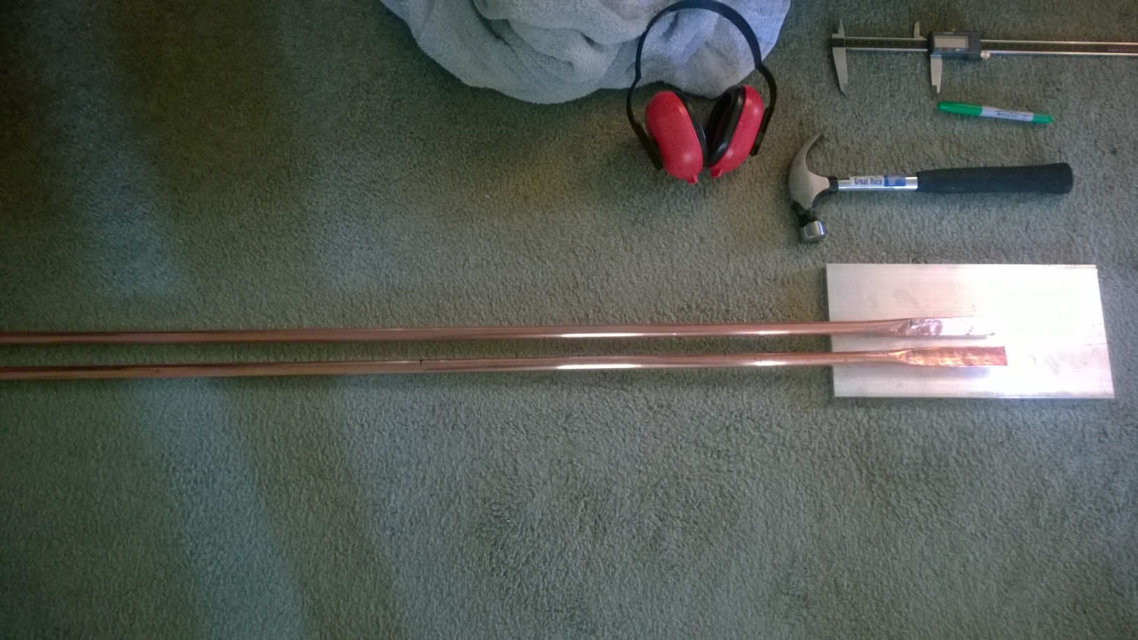

Posts: 928
The counterweight stabilizer for the baffle.
Copper pipe with end hammered shut and marked for bends. Bend pipe angle needed to attach at the top and bottom of the baffle. Add lead shot to add weight and then hammer the other end shut. Drill holes on 2" center to attach to the baffle bolts.
