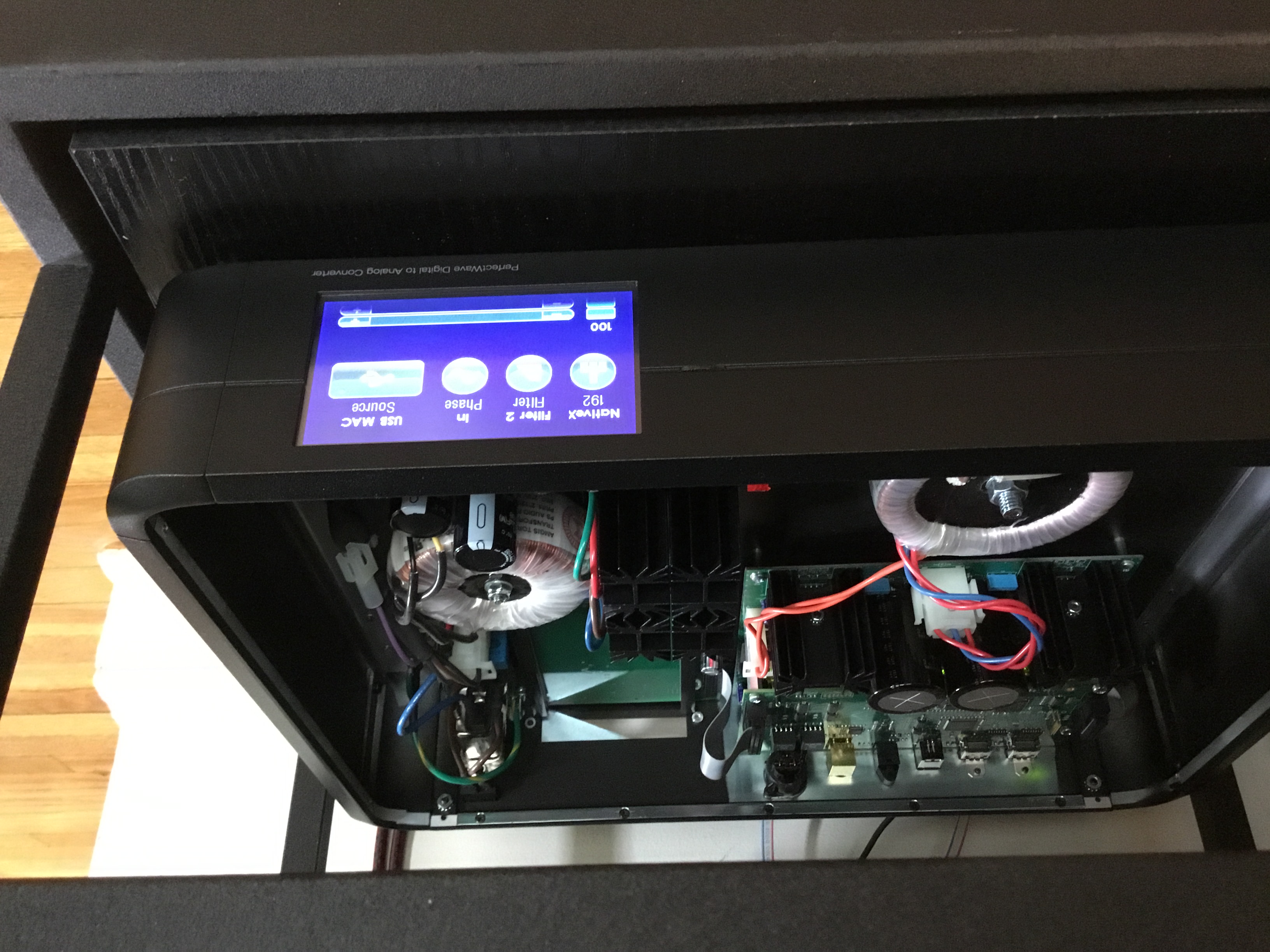

I was listening to different firmware versions on my DAC and a fuse blew during an upload. Are there any local places in the DC area that have these in stock? Radioshack does not carry them anymore, they basically just sell cellphones and cases at this point.
I got a couple off Amazon that will arrive Saturday but I want to get these replaced as soon as possible to see if this was some odd fluke or if something really went bad?

Well it appears to be an issue with the older firmware version I was trying to audition. It would initialize but the first time I restarted the DAC, the digital board fuse would blow.
At this point, I said screw it and took the 1A analogue board fuse (which was working fine) and placed it in the digital board and then placed a 5A fuse (I know, I know but the analogue board was working fine) and reinitialized/restarted with current firmware. It works fine and has been restarted a couple times now, no hiccups. I am glad I dont have a $4k paperweight. Will pop in a 1A fuse in the analogue board when they arrive tomorrow but for now I am enjoying all the extra oomph I am getting from that big 5A fuse in the analogue board. :sad-roulette:

The PWD II comes from the factory with some type of fancy audiophile fuse (gold caps and a cermic body). I think the glass fuse in the analogue board sounds in the direction of a little leaner/faster/more extended than the audiophile fuse which was smoother. I did feel there is a subtle but audible difference.
As a neuroscientist, I am very skeptical of the statement made above.
I have no intention of A/B'ing fuses and at best the difference is very small. But I do like the look of a nice, shiny glass fuse compared to the ceramic body on the audiophile fuse. And if the glass fuse blows, you can see it and not have to break out a voltmeter like with the ceramic fuse. The wire in the fuse is TINY, you can barely see it.
Since it is a slowblow fuse, I wonder if a breaker would be about as fast?
In any event, DAC works perfectly know so something about the earlier firmware was causing the digital board to pull more current at startup?
