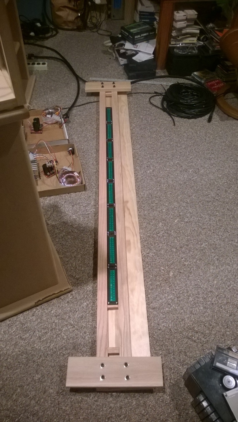

FPS planar drivers installed and screws started. Need a new #1 Phillips screwdriver bit as the old one is done. Then build the left baffle, install the drivers and wire both arrays to the amp modules.
I've switched to square drive screws for most driver installs because they are far less likely to cam out of the screw and have the screwdriver puncture the driver.

Tough to find them in a #4 size screw around my area. I do use hex heads for the larger ones.
