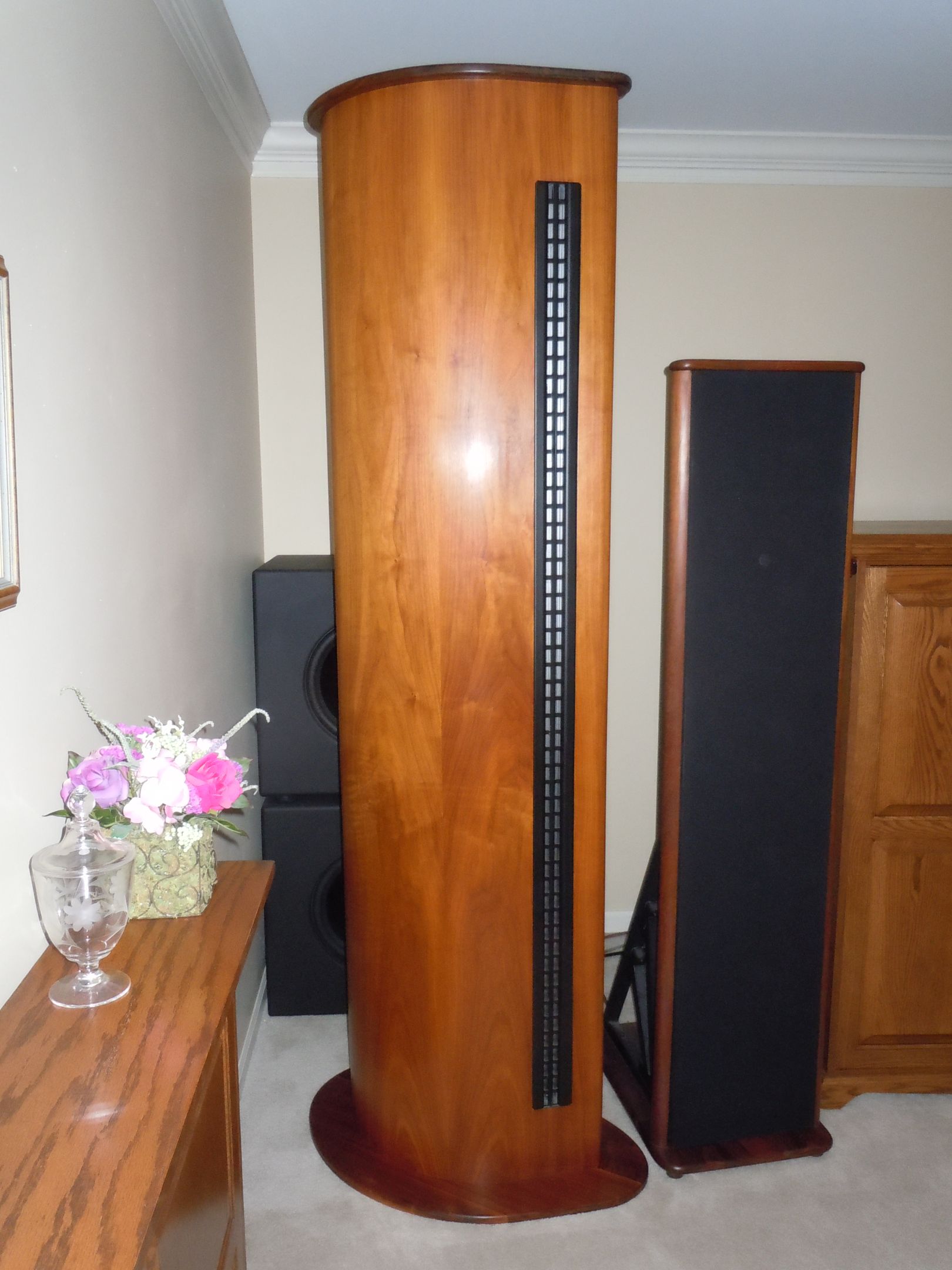

Sam:
I'm not too woried about the QB of a sealed box sub because I use DSP to correct any anomalies in response that occur with a QB that is not optimum. It also allows me to compensate for room gain or lack thereof at low frequencies. There are a lot of conflicting opinions about placement in a room of any sub or combination of subs regardless of enclosure types. The predominant thinking is in the corners at the floor or the middle of the walls at the wall/floor interface. I have always used the corners. I have to say that my current listening room is one of the worst I have ever had. That coming from a great room in my last home. It is frustrating. Using electrical eq is OK at long wavelengths but not effective at shorter wavelengths. Here is a photo showing the placement of one pair of my subs in the room. The subs are in the other corner at the right side but the two dipole driver arrays are not the same distance from the wall at the right side because the room has a window on the right side that caused some problems, That necessitated some interesting phase and timing corrections. Everything is always a compromise.
