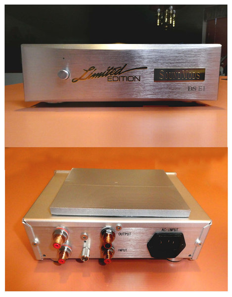

I had ideas about further improvement but the stock RCA jacks were not removable because of soldered connections to the threaded fitting – that made access to the PC board almost impossible without labeling and desoldering the connections as well as compromising access to the areas of interest on the PC board. So rather than screw up my first effort I obtained another E1 equalizer and pretty much performed a complete rebuild. Cutting out those cheap RCAs was the first and worst part of the project.

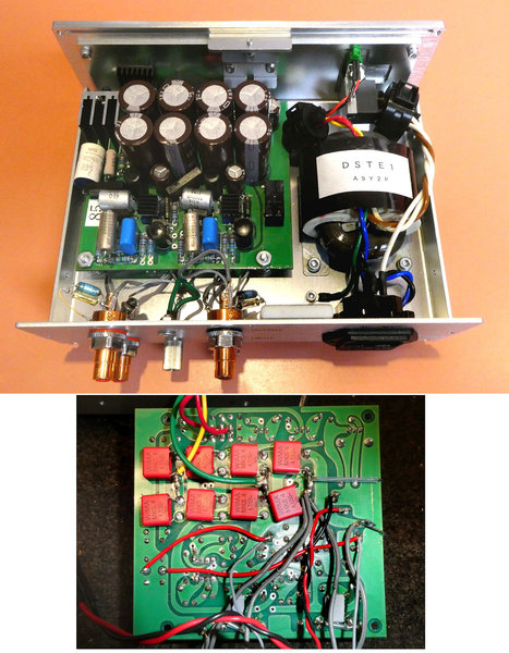

Replacement of critical path parts in order to upgrade the overall performance of the equalizer involved the use of Teflon and stacked-film polycarbonate capacitors, and Vishay bulk film and Vishay Angstrohm glass hermetic resistors. Power supply capacitors were bypassed with 4.7-ufd WIMA pulse capacitors. Direct PVC signal-path wiring was replaced with silver/copper Teflon wiring. The E1 had a switch for 50-Hz. roll-off and 30-Hz. roll-off that was connected with PVC wiring through the switch to short out the coupling cap providing the high-pass function for 50-Hz. I had no use for the 50-Hz. roll-off so I dumped the audio-compromising switch and associated PVC wiring and replaced it with a ½-inch dead short.
The JRC 072B J-FET op-amps used in the stock E1 are much better than anyone gives them credit for and were designed for high-quality audio playback. However, I installed DIP sockets in place of the op-amps so I could “roll” op-amps like rolling tubes. My first op-amp trial has turned out to be the charm – military grade dual FET-input OPA2604-Q1 op-amps (ceramic). These Burr Brown beauties were designed for professional audio equipment, PCM DAC I/V convertors, and spectral analysis equipment.
Also, to enable long-term reliability, heat sinks were installed on the op-amps and I added heat sinks to the power supply regulators. Constrained layer damping enhanced the case work to limit acoustic breakthrough along with a sand-filled power line fuse – plus I added two RFI/EMI ferrite filters to the power supply.

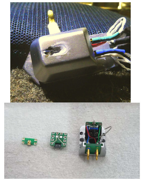

I also modified the E1 cartridge as well. That work involved applying a polymer resin to the cantilever and inserting acoustic fill inside the cartridge-body hollow cavity to suppress subtle roughness that could be attributed to the cantilever or other issues with the cartridge construction.
