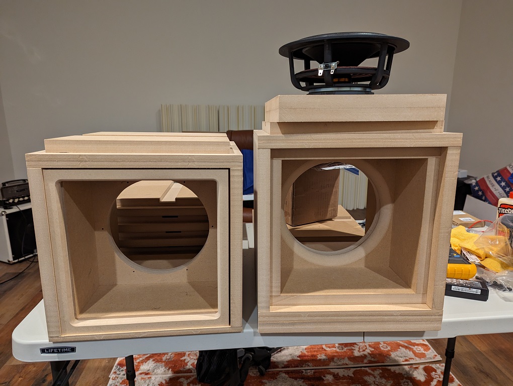

Checked out the grill frames that insert into the OB H-Frame module face.
Then glued and clamped the first module to do a test fit of the 8in servo woofer.
Will wire them up before installing them in the H-Frames. They are a tight fit.

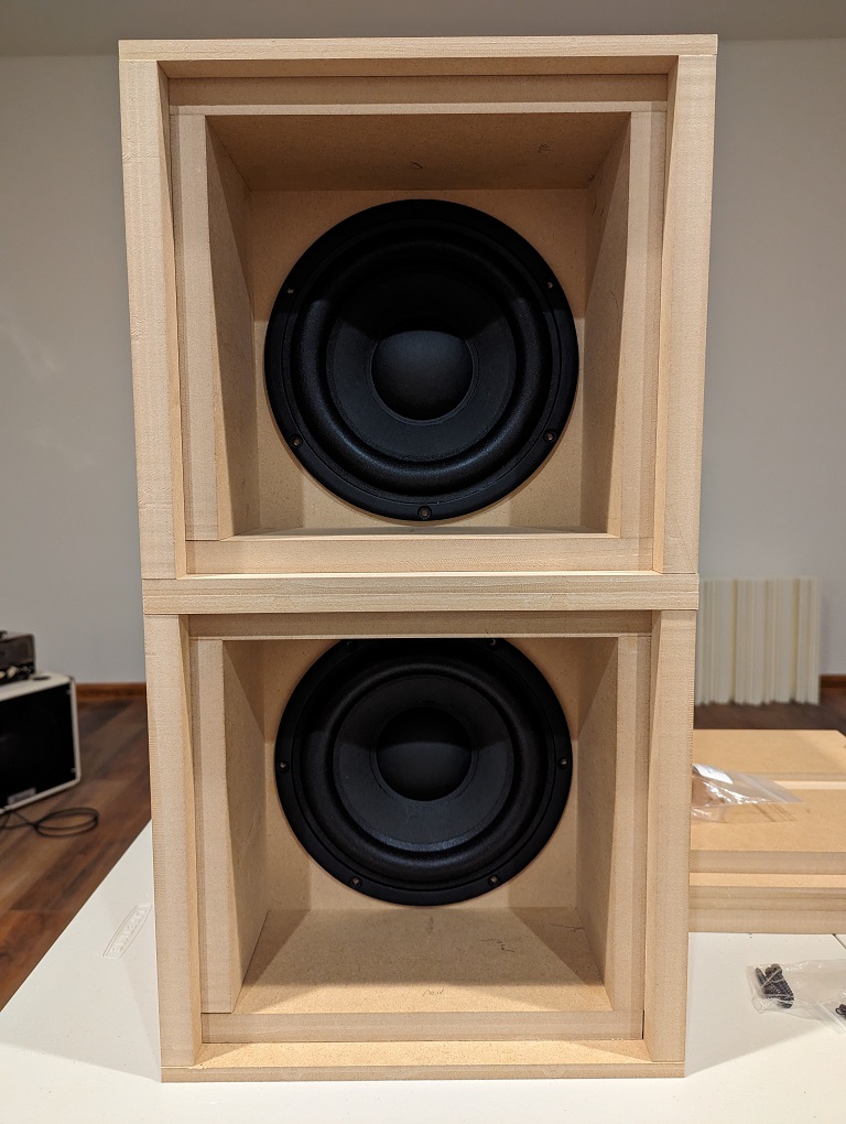

Have two modules with the 8in servo drivers installed and wired.
Time for some testing.
