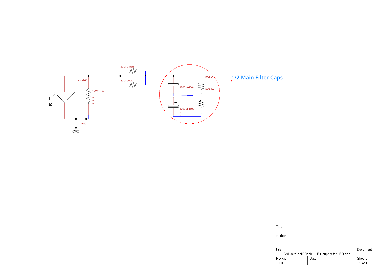

I traced out the circuit that is in place
B+ supply for LED.png [11.1 KiB]
Not downloaded yet
I am going to go in and check voltages
Not downloaded yet

I get 460V off the main filter caps
0 volts across the LED
 Post subject: Re: need help
PostPosted: April 7th, 2022, 11:50 am
I know you guys are probably bored with this simple problem, and I apologize for my ignorance but this is where I am at now.
The LED is bad. The two 200k 2watt resistors in parallel off the B+ are open.
So I need to increase both resistance and heat dissipation.
so besides a new LED how much should I go with the voltage drop resistors. the two 200k 2 watt in parallel is 100k 4watt.
I can double the wattage, there is plenty of room
I am wondering why the 100-kOhm resistor across the LED? For me it seems that a 400-kOhm resistor in series with the LED dropping down from 480-volts limits current to 12-ma.
Again -- not all LEDs are created equal and if 12-ma is too much then use more resistance. When I had this issue I just put a pot in series -- I adjusted for the desired light output than substituted a fixed resistor

I was curious about that 100k in parallel also. Research calls it a current limiter also.
I am ordering a bunch of 430k 5watt that I can try four in parallel and keep the original design just beefier
and I can try just one 430k in series without the parallel 100k.

I have no clue where you got that information, but a LED (or any diode for that matter) is a dead short compared to the parallel 100K-ohm resistor. ???

Yes I do not understand why the parallel resistor is there. I must have misread the research.
