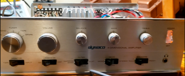

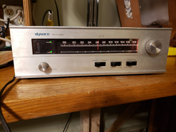

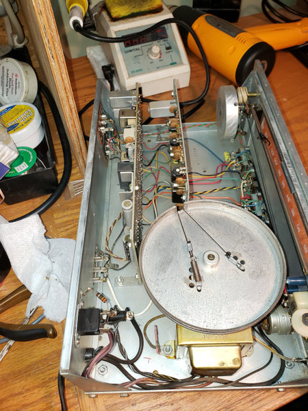

The FM-5 was easy, it "worked". Belonging to my deceased brother and built January of 1970, it was filthy inside and out. The "stereo" and "tuned" lamps had failed, and these are part of the mute and tuning circuits. Managed to replace them with LEDs; a resistor change kept the current at expected levels. Ten minutes of air compressor time to clean the inside, burnishing the RCA jacks to clean them up a bit, lots of Goo Gone and Alcohol cleaned it to an acceptable level. The grooves in the knobs took a half-hour of jeweler's screwdriver scraping.
The SCA80Q was a bit more of a challenge. Went Dyna went out of business, my dad, brother and I went to the Circuit City warehouse sale of all that remained of their stock. None of us had a lot of money to spend. There were a pair of MKVI amps I was drooling over. Dad bought the SCA80Q and an AF-6. These sat atop his Capehart console driving A-25 speakers from the 70s until they moved out of the house in 2000. They played EVERY day.Sometime after moving, the amp died. When dad passed away in 2009, I inherited them. The amp no longer worked, but the tuner survived.
Digging into it, the power amp was dead, phono and line sections, as well as power supply were okay. So, I pulled out the power transformer and power amp. This build had to be all off-the-shelf. The perfect toroid was on the shelf, along with an LM4780, board, heat sink and power supply board; so in they went. The input and phono stages needed 17.5 and 24 volts, so a couple of LM317s on perf board fixed that. I replaced all caps and resistors on the phono/line boards, eliminating electrolytics where possible and where they had to remain, they became Silmics or similar. As you may know from a previous post, I broke the selector switch in the process of the build. The replacement was a 2-pole 5 position switch. Since the unused inputs could no longer be shunted to ground, the input wiring had to be re-done with individual twisted pairs (Teflon insulated copper, woo-hoo). Also, the phono equalization had to be hard wired to the board. The "Special" input became a line-level input, since we have zero need for two phono inputs in the amp.
Hooked it up and it sound way better than before. I'm pleased.
