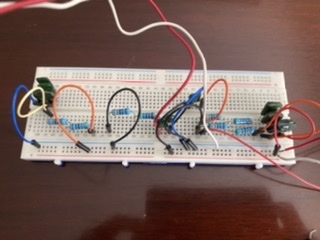

Few months ago I breadboarded a 3-way crossover using cheap caps and resistors from Amazon. Surprisingly, it sounded very good.
BTW, what resistors and caps do you recommend?
