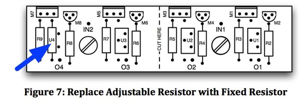

Install the CERMET pots (U4-U1), followed by the grid-stopper resistors (R9-R2). If fixed current-adjust resistors are used, replace the pot with a fixed resistor. For example, Figure 7 shows the leftmost adjustable resistor U4 replaced by a fixed resistor. The other three CCSs have similar pads for fixed resistors.

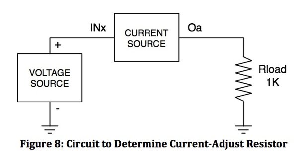

An easy way to set the current is to connect a 1KΩ resistor from one of the outputs (O1 O4) to ground, and a power source from the appropriate input (IN1, IN2) to ground as shown in the figure below. Apply at least 20V DC to the current source and adjust the appropriate current-adjust resistor to the desired current output. Measure the voltage across the load resistor (Rload). Compute the output current, which is the measured load voltage divided by the load resistance (1,000 Ohms). For example, to adjust for 30 mA, there will be 30 Volts across the load resistor and at least 20 Volts across the current source, so a minimum of 50 Volts DC is required from the power source. Other values of load resistors can be used to allow other voltages for setting the output current - just use the value of the load resistor in the equation.
