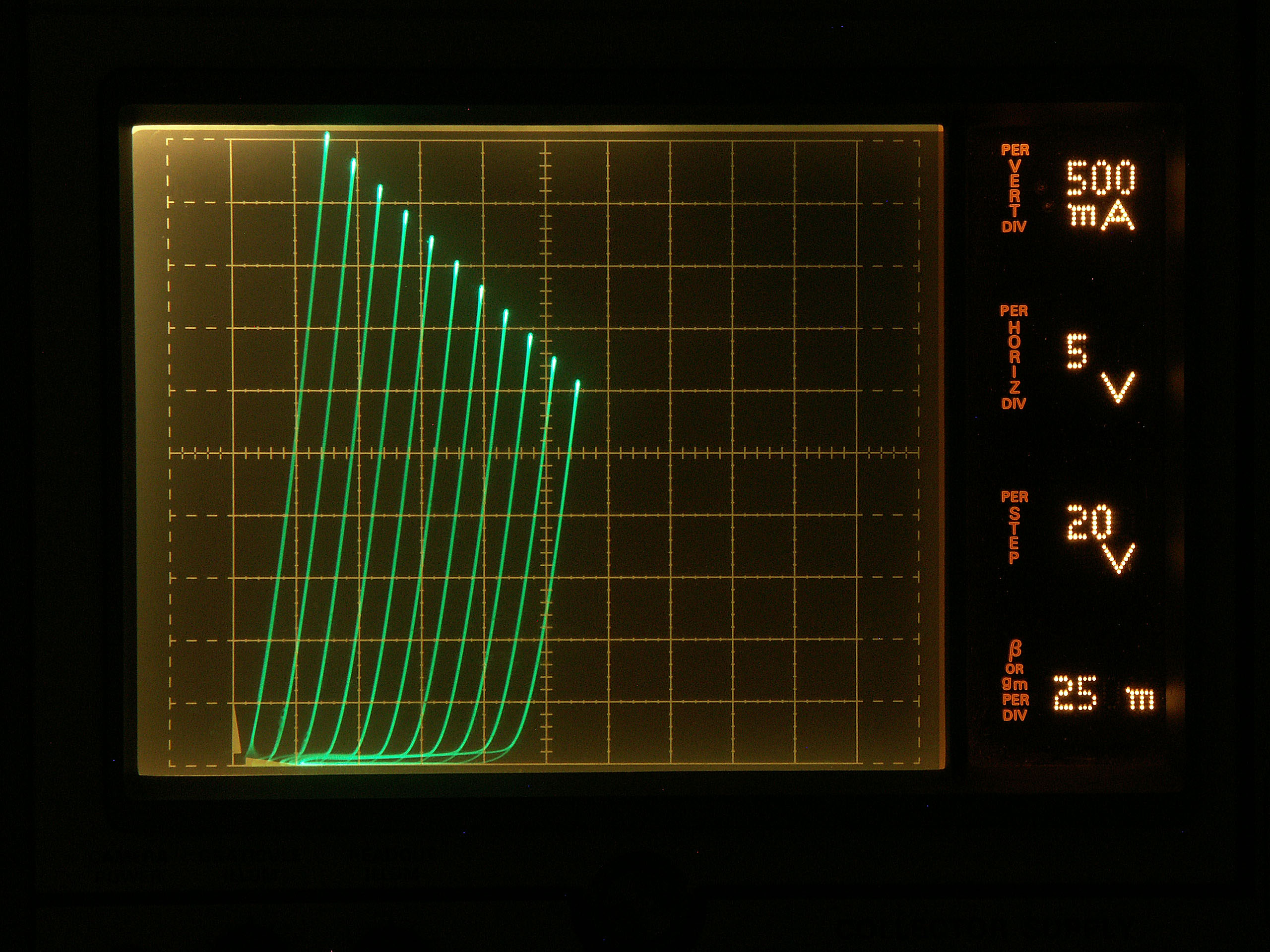

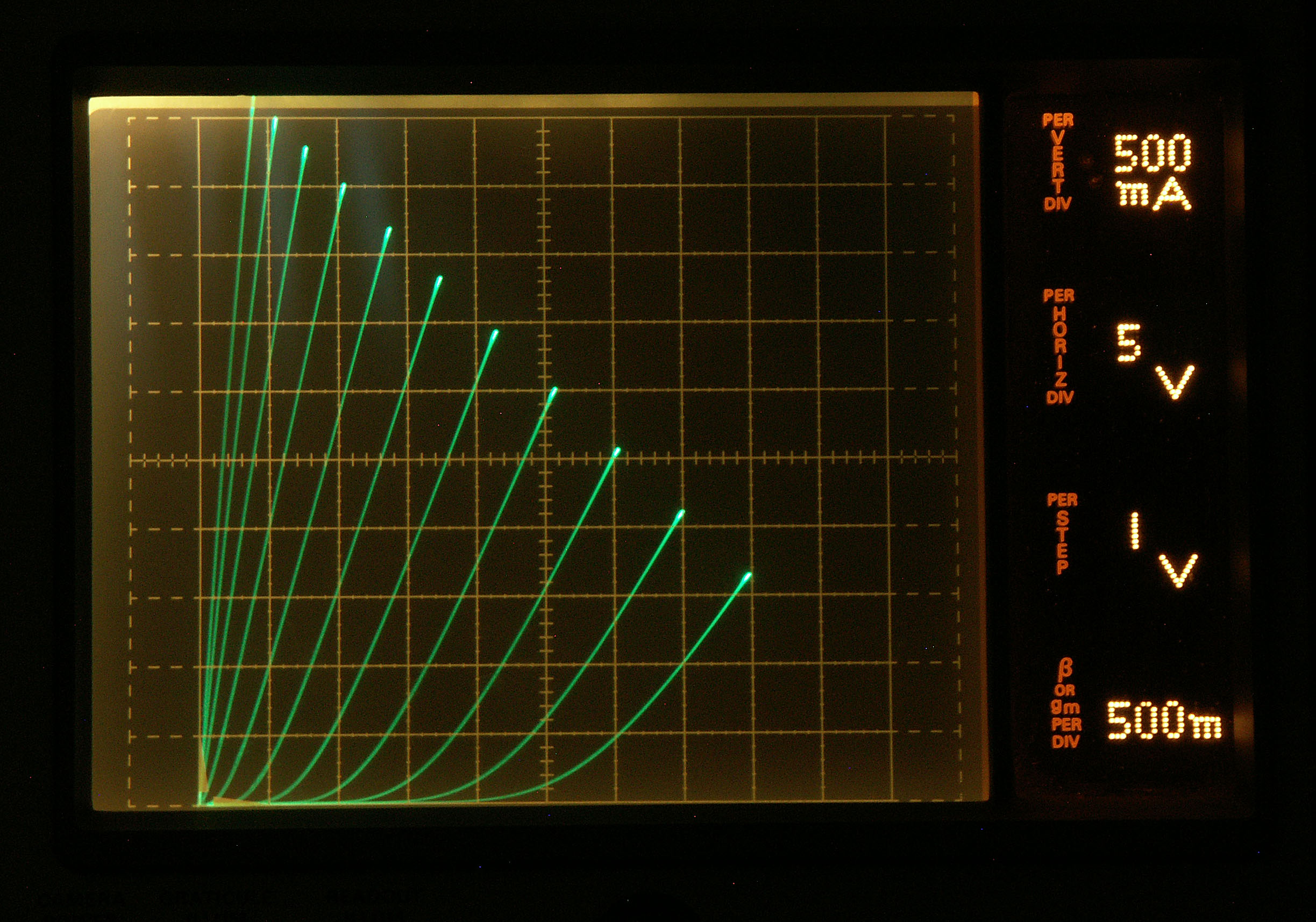

Thanks or the kind words. One minor correction. The FETs used in the amp are not MOSFETs, but rather VFETS. MOSFETs have the similar characteristics to pentodes while the VFETs behave like triodes. I'm including characteristic curves of the VFET, an 845 and a pentode for comparison.
