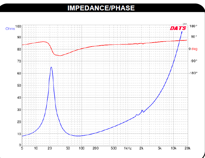

In addition to the sensitivity issue there is another factor to consider if you are going to use the drivers around resonance. As the driver goes from just below resonance to just above resonance, not only does the impedance change but it goes from leading to lagging. I'm enclosing a plot of a typical impedance curve. A few things are noticeable.
First at resonance the impedance increases dramatically which greatly reduces the ability of the amplifier to control cone motion because of the limited ability of the amp to provide corrective power to the driver. Second, notice that the driver goes from being more capacitive to more inductive. Not every driver of the same make and model has an identical Fs. If they are in parallel it is of no concern. If they are in series, one driver affects the motion of the other. Each driver sees the other driver as a generator with different characteristics. I have connected the same models of driver in series and using a stroboscope have noticed that at resonance the motion of the drivers can get out of phase with one leading the other. That did not happen in a parallel configuration because in almost all cases the amplifier can swamp out the effects of the drivers because the amp is connected to both as separate devices. In series the amp output is fighting with the out of phase energy of the other driver. With a series configuration since the cones are out of phase, the acoustical output is reduced and you will get a response dip at resonance.
At the Midwest Audiofest in 2016 where I was a judge, after the competition was over one of the competitors came up to me and complained about a response dip in his arrangement of multiple 15" drivers connected in a series arrangement. He couldn't understand it because the drivers did not have that dip when measured individually. When I asked him if the dip was at resonance he replied yes, how did you know? I explained this condition to him and it then made sense.
I have since avoided using series connected drivers if they are going to be used around Fs. I do use them in series when they will be in the area above resonance, for example with my dipole mid bass array where I have three series connected pairs of drivers then wired in parallel. The Fs of the drivers is 25 Hz but I use them from 100 to 300 Hz and have no problems.

PostPosted: November 2nd, 2018, 8:54 am
Tom,
Was waiting for you to reply on this. I remember you telling me there was an issue, but forgot the details. Thanks.
My drivers have an FS of 37.7Hz. Plan is to use them over 100-125 Hz, depending...., so hopefully no issues.
