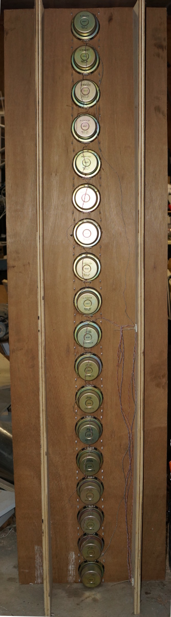

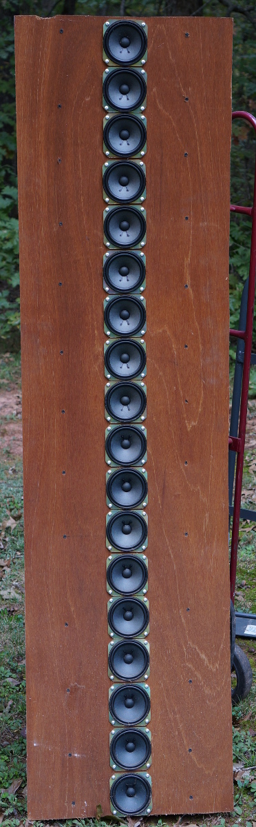

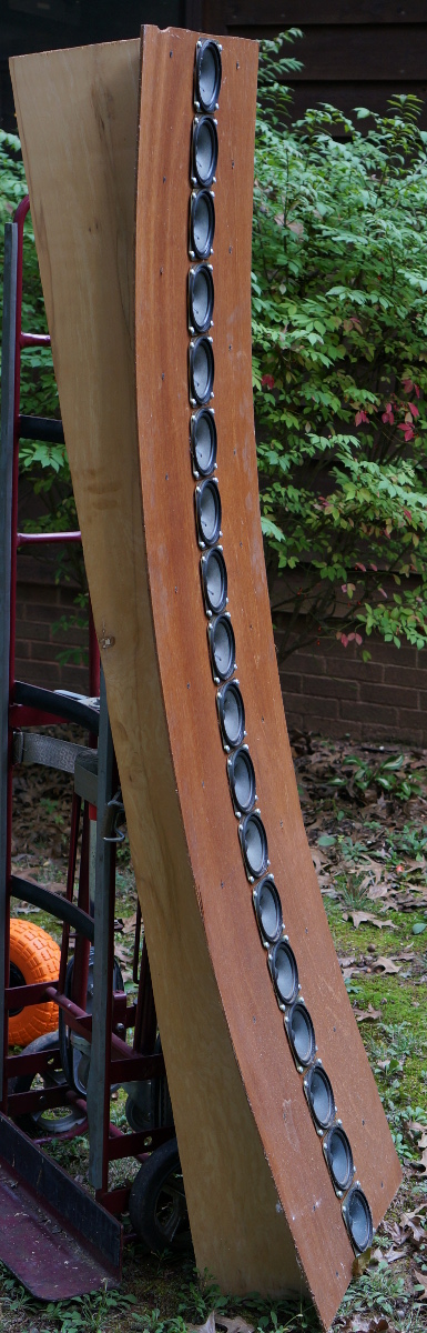

18 4" full-range drivers per side, series connection of six groups of three drivers in parallel. I can't remember if the drivers are 4 or 8ohm, impedance will be either 8 or 16ohms. Baffles are curved so that all the drivers are the same distance from the listener with approx 10-12' listening distance. You'll need to measure the radius to be sure, it's been a few years and I don't remember the exact distance I cut them for... These drivers have a bit of a peak in the upper mid-range that you'll need to design/build a notch filter for...
