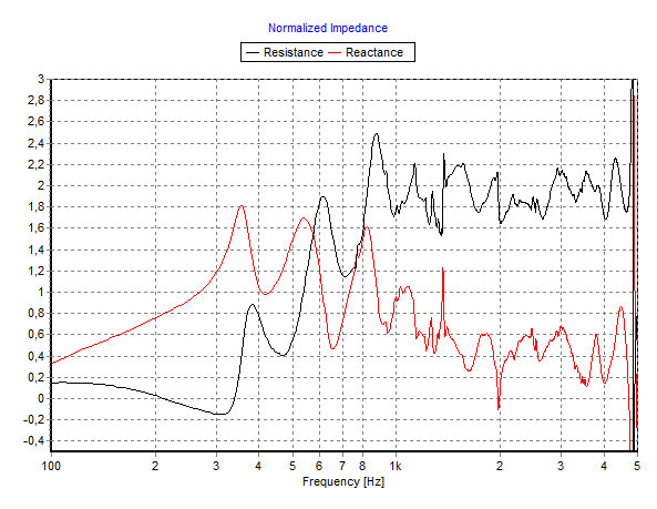

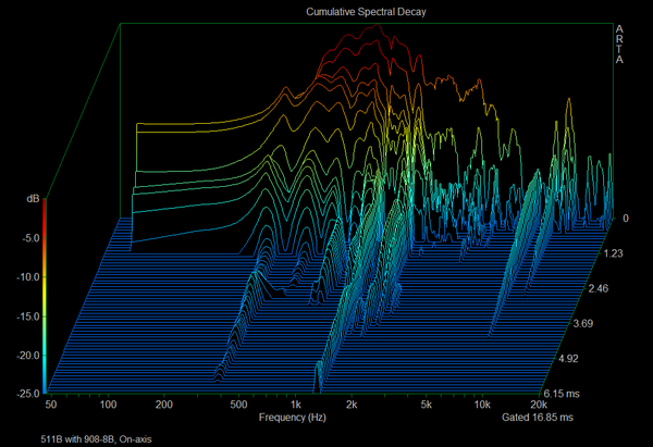

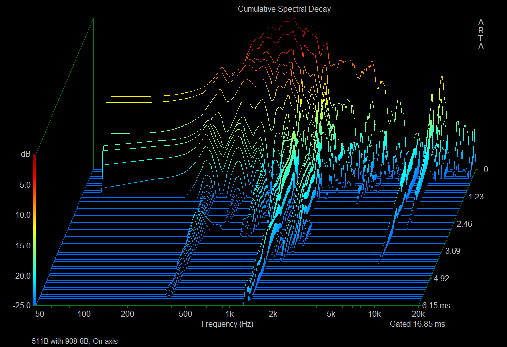

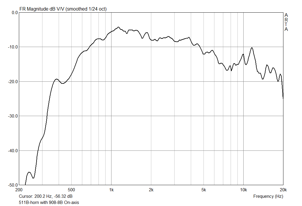

Starting a new thread to present some measurements of the 511B provided by Bjorn Kolbrek, taken in anechoic chamber at NTNU, Trodheim, Norway. 902b driver.
Frequency response shows broad 5dB peak in presence region, 12dB rolloff below~800hz
Impedance plot shows serious dropoff in loading below 800hz, Various major discontinuities through frequency range. Blue is Resistive component of Z, Red is reactive Z.
FFT shows various nasty hangovers and delays. Check it out.

The problem here is that the horn was tested with a horn driver that has the "Tangerine" phase plug and a loading cap. Neither of which have proven to be audiophile worthy when compared to the legacy 800 series horn drivers. Maybe start over.

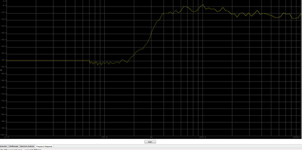

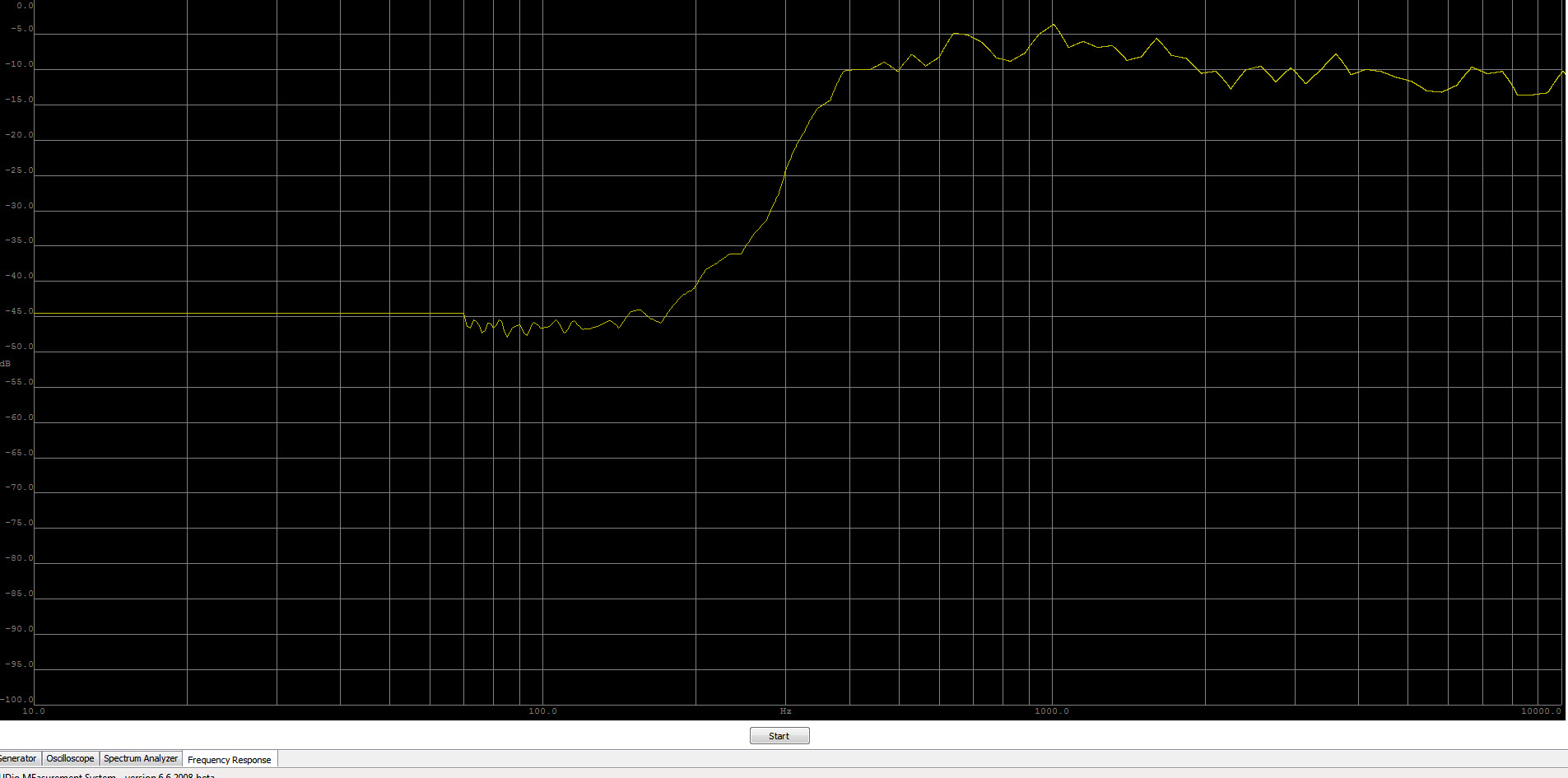

I measured the freq response of the horn last night. This is my first attempt ever. Used Dayton Audio's EMM-6 mic with freeware AUDMES software. EMM-6 is not tracking below 70Hz, it could be defective. Returning it an d getting Berhinger ECM-8000. AUDMES is rudimentary software.
Measurement is taken with the mic about 1" from the mouth of 511B which is driven by 802D driver. Crossover was at 500Hz and the attenuator circuit was on. Disconnected the woofer for this measurement. I do not see the rolloff below 800Hz or in the HF ranges. It is pretty much flat within +/-5dB range all the way from 500Hz to 20kHz. Since the mic I used is entry-level and suspected to be defectivve, the +/-5dB band could be larger or smaller.
If Berhinger mike is better, I am thinking of investing in True RTA Level 2 or 3.
Any recommendations for budget mics and Software?
